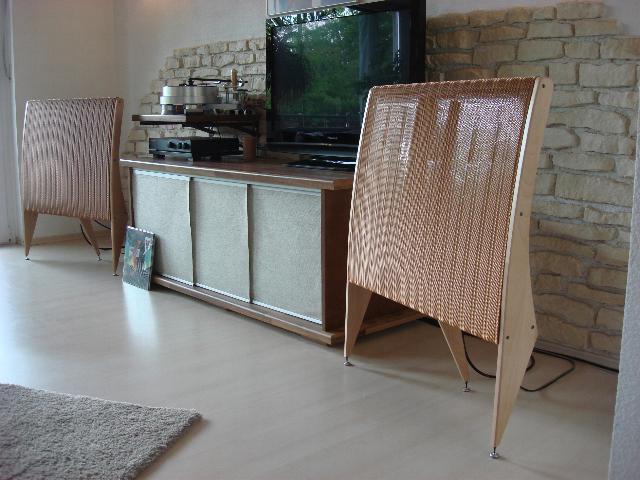

crackling. Looking to trade it. Ideally I'd love to get my esl57s off the ground and up on some stands, so if someone wants to make me a set I'd be very happy...Here are some examples ;-)

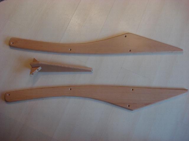

Or I'd swap for these bit's of timber

mmm those last ones are nice, aren't they? You'd hardly have a pic from the back?
I should be able to help you out....
Re: Cambridge a&r a60
Hi David Am I reading this ad right. Do you have the 3 pieces of timber pictured and want 2 more sets like it? If so I could try make reaonably good copies from them. Would be afraid to use the original as a template in case the router takes a chunk out of it. I have no phonostage so one would be useful. Of course that would mean I need a good deck, uh maybe this isnt a good idea. See how you get on here as it wouldnt surprise me if some of the forum members have production facilities to run up a 1000 versions of what you want.

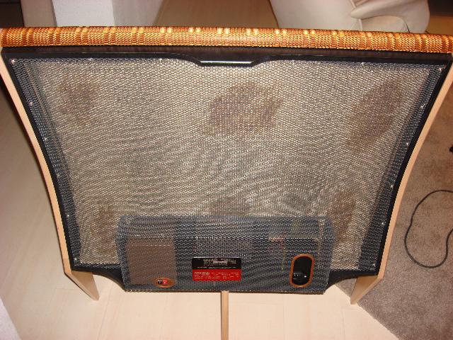

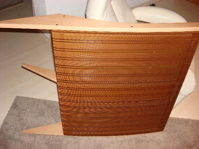

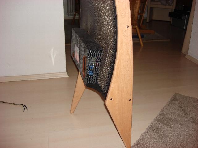

I have loads of pics, ;-)

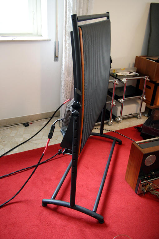

Quad Gmbh sell these stands for €500+ not including postage!!

Those ones seem to tilt the speakers back slightly - less than the original, but certainly more tipped back than mine. There seems to be 2 preferences on this....
I like the idea of the side braces extending to the floor though - should make it very sturdy I think.

Post by DavidMc »
I managed to make a template of the speaker stands using my esl upended on it's side, I have given the stands a 25cm lift off the floor, so from floor to top of speaker is 95cm(I had thought that spike could be mounted for further lift). The angle of the back leg is tricky(for me) to work out, but I've made a stab at it. Problem is I have a drawing to scale of legs, should I scrunch it up and shove it in the computer? :-)
