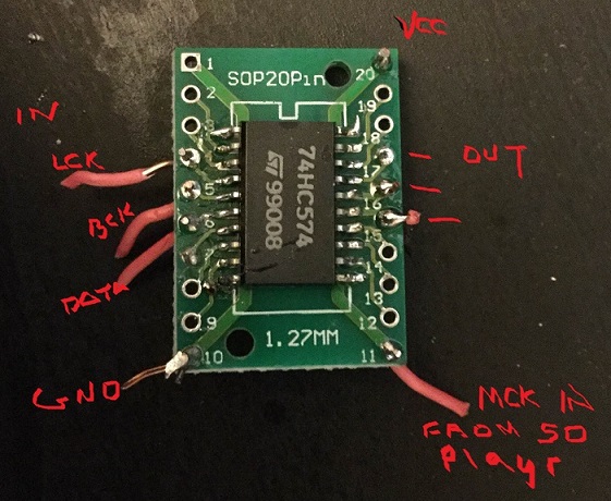

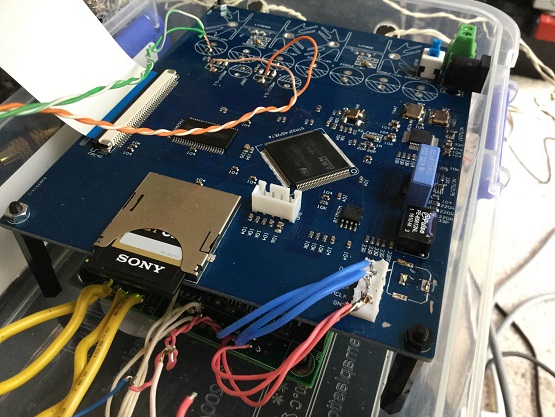

Pics

574. I feel like I missed something but not sure where.

nige2000
Posts: 4253
Location: meath
Re: Lossless SD digital Player is computer audio now reborn?
Post by nige2000 »
wushuliu wrote:574. I feel like I missed something but not sure where.
Gnd on pin one please for enable
nige2000
Posts: 4253
Location: meath
Post by nige2000 »
Need to get a 32.768khz clock to replace that crystal
Its the most benificial one and very important
Also these clocks should have a vcc from lifepo4 cell wired direct to minamise noise
I mounted the clocks vertical to do that
Any chance of shorting the i2s more?
