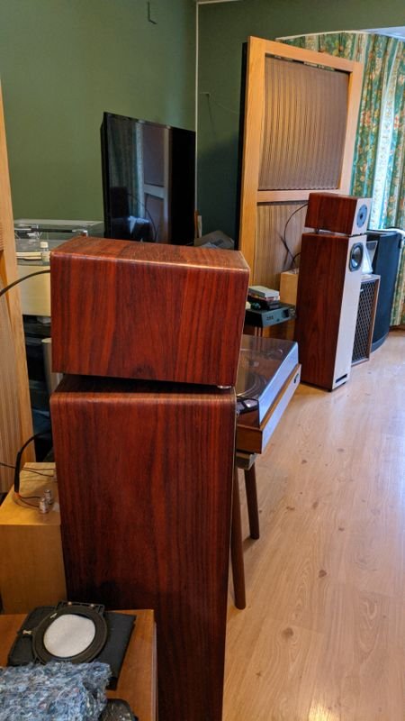

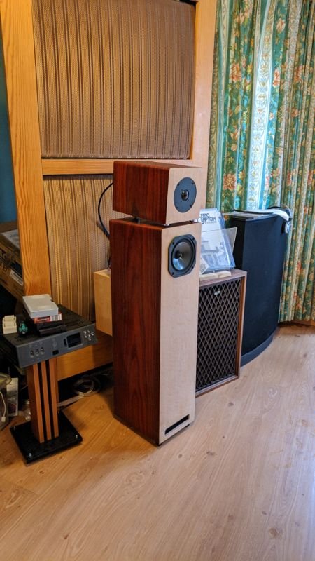

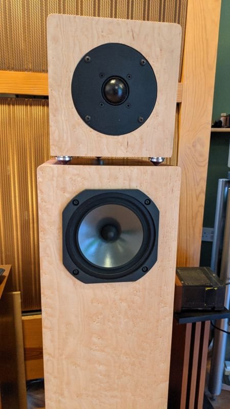

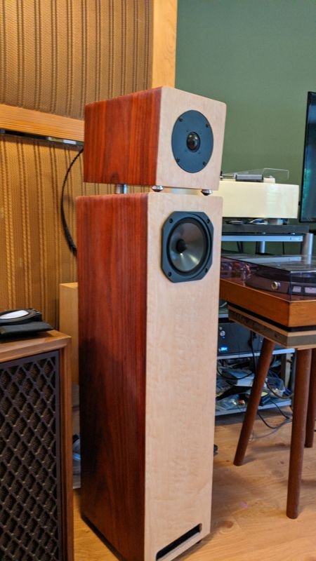

Can you post a pic of the fronts with drivers in place?
Ask and ye shall receive!!

watsapp photos I saw looked really nice but the ones posted today here are fabulous. Maybe you have added a few coats of polish? They look incredible Fran.

Actually in those pics I had just keyed the surface as I need to give them another couple of coats of oil to bring up the lustre a bit more. So, its probably a bit dull in the pics. I'm not looking for a high gloss at all, more a satin with good depth to the finish.

Great work Fran. Going by the pictures I think they look better than the Audioplan Kontrasts. I really like the way you can position the tweeter angle. I suspect there will be a long queue outside your gaff to hear these.
