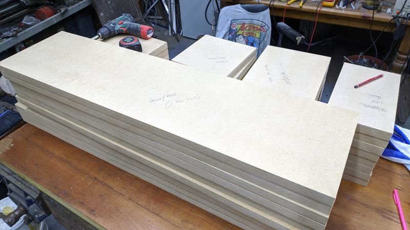

So, looking at the specs on the mid/woofer, I knew if I went for a box around 38-40L I could get meaningful output down at about 40hz, but that this would be the limit. So given ear height, some guesstimating, I went for a bottom box 950mm tall which when put on feet would put the mid/woofer at ear height.
The next decision was what to make it out of. Nearly all recommendations are for either baltic birch ply (high quality ply) or MDF. The ply is quite hard to get, and I knew I had a supplier of good quality MDF not all MDF is equal). So I went for 25mm thick MDF to give a balance between using MDF and achieving stiffness in the box. Tweeters are essentially sealed units, so the box doesn't matter as much for them, although you do still want a stiff rigid support.In any case, given I was already cutting 25mm MDF, the tweeter boxes are cut from that too. Now, I don't know if any of you have ever lifted a sheet of 25mm MDF, so let me tell you right now its heavy as f%&k. Very luckily, the company supplying the MDF also cut it for me to the final panel sizes on their CNC saw and I tell you now, its an absolute Godsend. The pic below is the pile of cut pieces. I got a couple of extra front panels and bits cut to allow for the inevitable mistakes.

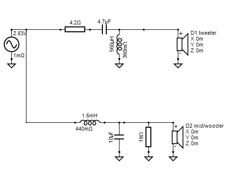

So the next step was to define the crossover. This is made up of two filters; one to cut frequencies above a certain level for the mid/woofer, and the other to make the reciprocal cut for the low frequencies that would otherwise go to the tweeter. The thing is that it is not possible to have a hard limit on this, and it is in itself a bag of constantly moving snakes. Such filters are defined in "orders" - this means how quickly the frequencies tail off. So a first order has quite a gentle slope, a second order is quicker and so on. The higher the order, the more and bigger parts you need. You loose something in every extra part you add, but you also loose something if you don't get the slope right as the driver will be either trying to do something its not designed for, or the overlap between both will be less than perfect.

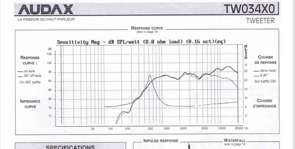

I don't currently have the facilities to do measurements on the drivers, so I was dependent on the spec sheet that comes with the drivers. The simple crossover calculators that you find online are pretty much completely useless as they don't take into account impedance or the box. However, you can use more complicated software that will give you a really good starting point. The one I used is called vituixCAD and is pretty user friendly.
The first step was to get the graphs for SPL and impedance into the software. On the modern drivers this is usually available as a file you import, but for the ones I was using it means copying the graph and tracing it in using a tool in the software.

So, the great thing about the better speaker design software is that you can endlessly mess about and see (in theory) what each one does to the response. My goal was to have a proper crossover, but with as few components as possible. The tweeter here is a little more sensitive than the mid/woofer, so the first step I took was to drop in a series resistor to bring that down a bit. A resistor like this affects all frequencies equally, so it drops the level right across the board. With an approximation in place, the next task was to add the 2 filters to cut the highs to the woofer and the lows to the tweeter. If you scoot back up and look at the graph for the mid/woofer, you'll see a peak at around 3000 hz. That is what is called cone breakup, and basically we need to stay away from that. Likewise if you look at the tweeter graph you'll see it slopes upwards to about 1000hz, so we want some comfort and stay well above that. That leaves a crossover point somewhere between 2000 and 2500hz as the optimum spot. After much modelling and trying different configurations, the V1 crossover is shown here:
The graph here shows the resultant modelled SPL response curve, which is not as ruler flat as you'd like....
That little bump at the low end should help give a bit of heft down low. The crossover point ends up nicely around 2300hz. The heavy black line in that graph is the cumulative response, and the other two lines show the individual responses for each driver. Lastly, a resistor across the woofer helps with the impedance curve which should make them a bit easier to drive.
Bear in mind that the crossover here gets you in the ballpark only - there's plenty of tweaking as you go and actually hear them in the box.
