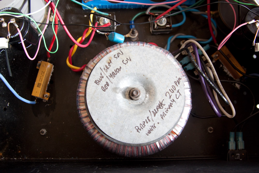

So hows about an update? Well I only got to take some pics last night - first up here is the transformer. This is pretty massive!!

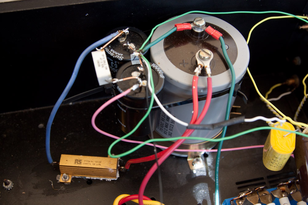

Next is the capacitors and resistors for the power supply (CRC filter). The big resistors at the bottom of the case are 10R and these get pretty warm!

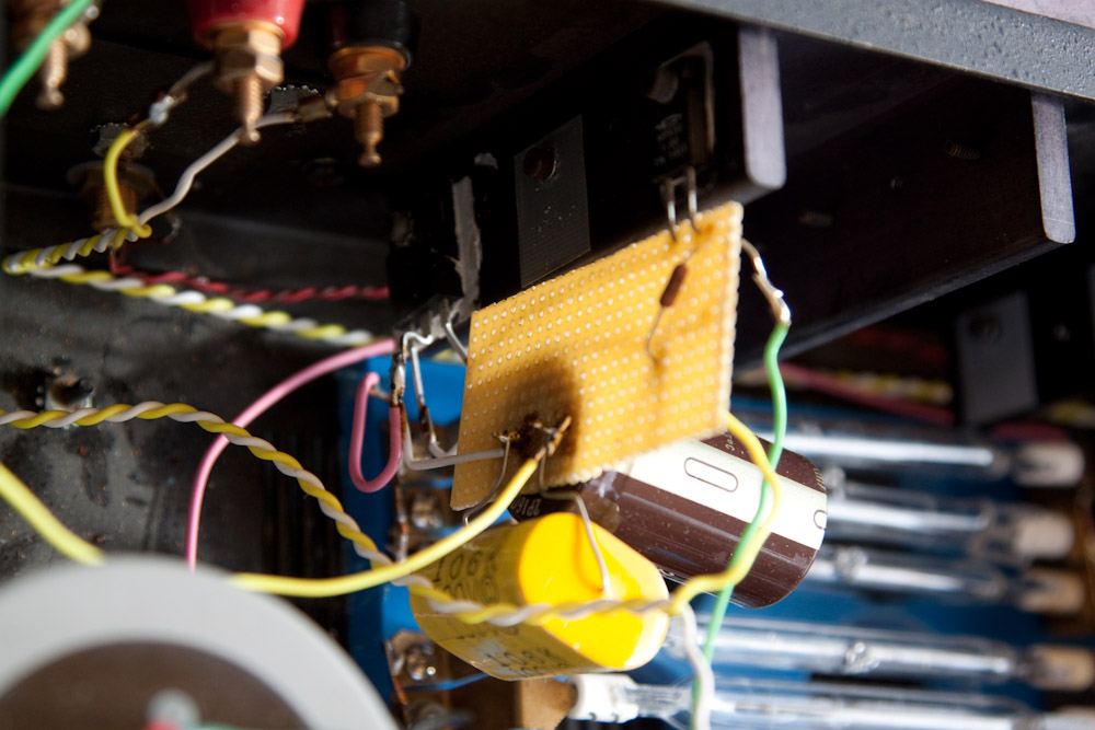

Now, next up is the actual circuit on a bit of perfboard. Its not too easy to see this exactly, but you can make out the mosfet at the bottom and the source resistor attached to the heatsink on top. The big brown capacitor with the gold stripe is C3 from the earlier schematic - and this is paralleled with the yellow film cap to improve the highs a bit.

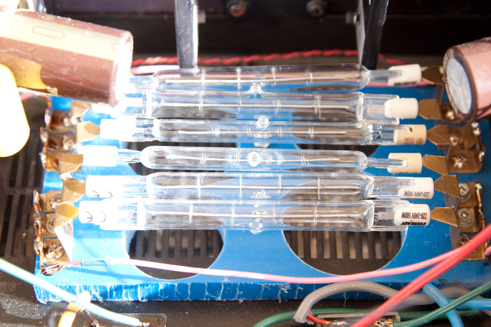

This is how I used the light bulbs to set the bias current - 3 bulbs per channel, in parallel, and these set the bias for the mosfet.

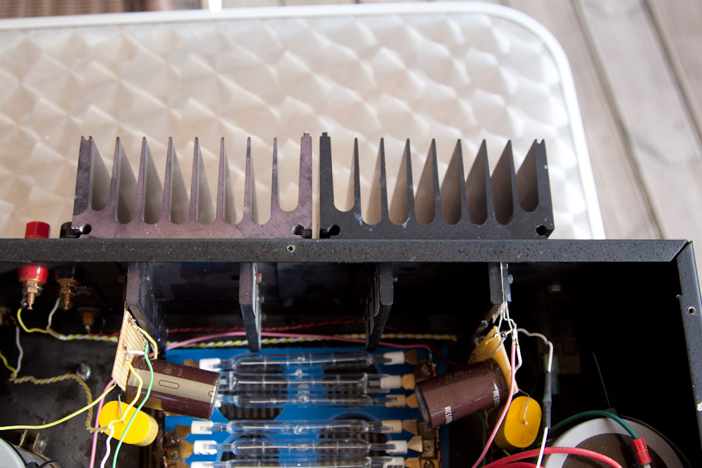

Zooming back out a bit, you can see the 2 heatsinks on the back of the case and the way each circuit is held to them.

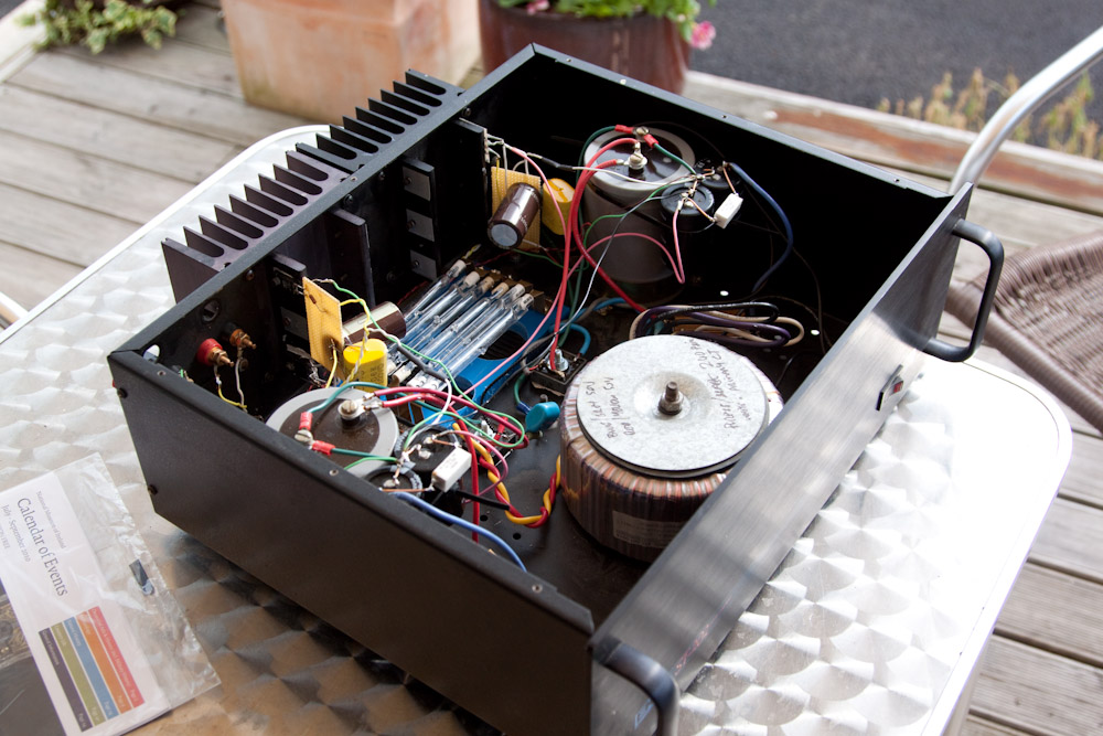

And a bit further back, this is the whole amp:

My builds nearly always end up like birds' nests. Just because what happens is that I'm building them to try out, then need to swap in or out this component or some other thing, and before I know it, it looks like that!! Having said that, there is no hum from it (apart from a small transformer buzz that is only audible up close to the amp).
This thing gets hot. Good and hot. I reckon the heatsinks get to 60deg C (you'll put your hand there for about 5 secs, although it won't mark or burn you) and the internal about 5 deg C less. Ideally, bigger heatsinks are called for.....

are those the original transformers?? If so they always had a humm....!!

Good to hear that about the transformer - I was a little,worried that I was putting too much of a load on it. We'll have to get you down for a listen soon....
