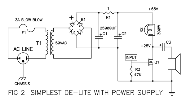

So the next thing is to have a look at what is actually required. So the basic circuit for this amp is very simple:

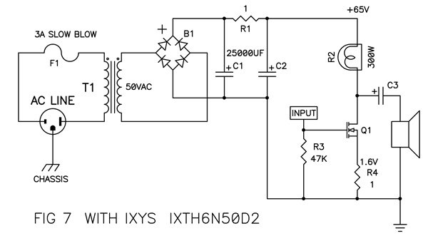

but we are going to go a little further and change it as per the instructions for a little higher voltage supply, bit lower distortion and a little bit higher wattage....
as you can figure out, both are pretty much the same, except that the mosfet used is different. This circuit also gets rid of the input capacitor. Personally, I have found that the fewer capacitors are in the signal path the better. Its not always possible, but in general, the fewer the better. So thats why I choose the second over the first circuit.

Ciaran, the light bulb acts like a big resistor - it is a constant current source which provides the bias for the mosfet. The idea here is that a big power resistor can act as a CCS, but such resistors tend to be expensive and hard to find. So, the light bulb is a very good substitute, requires no heatsinking and is widely available. As you will see, it takes a bit of experimentation to get the right kind, but it does work!
