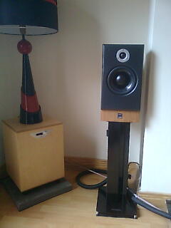

Post by Matt »
No problem Tony
Just remember that you need a stereo pair of interconnects exactly as you would for a cd player.
A subwoofer cable is only a single interconnect used for surround amp's dedicated sub output.
I have my speakers either side of the fire place with the sub in the left corner and it works perfectly
