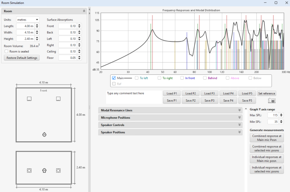

Think you will get a strong room modes around 41-43hz (for 4m and 4.1m lengths). Room simulator in REW shows a big peak/dip if you're sitting closer to the room center, but pushing speaker around 0.5m from the wall, and sitting close to the back wall, shows a bit more flat response. But, didn't find this room simulator too accurate in my case (4x5m), expect those room modes, they will be there, so its maybe good to work with them and not against them! Meaning, get speakers that start roll off in the bass region much higher, around 55-60hz for -3db, and to be -6 to -9db at 40-45hz, then room will boost that part.
Second concert is a dip around 70-80hz, SBIR (https://gikacoustics.net/speaker-bounda ... onse-sbir/), to fix that you'll maybe have to treat the wall behind the speaker...
Screenshot 2024-10-17 112814.png (227.29 KiB) Viewed 8003 times
