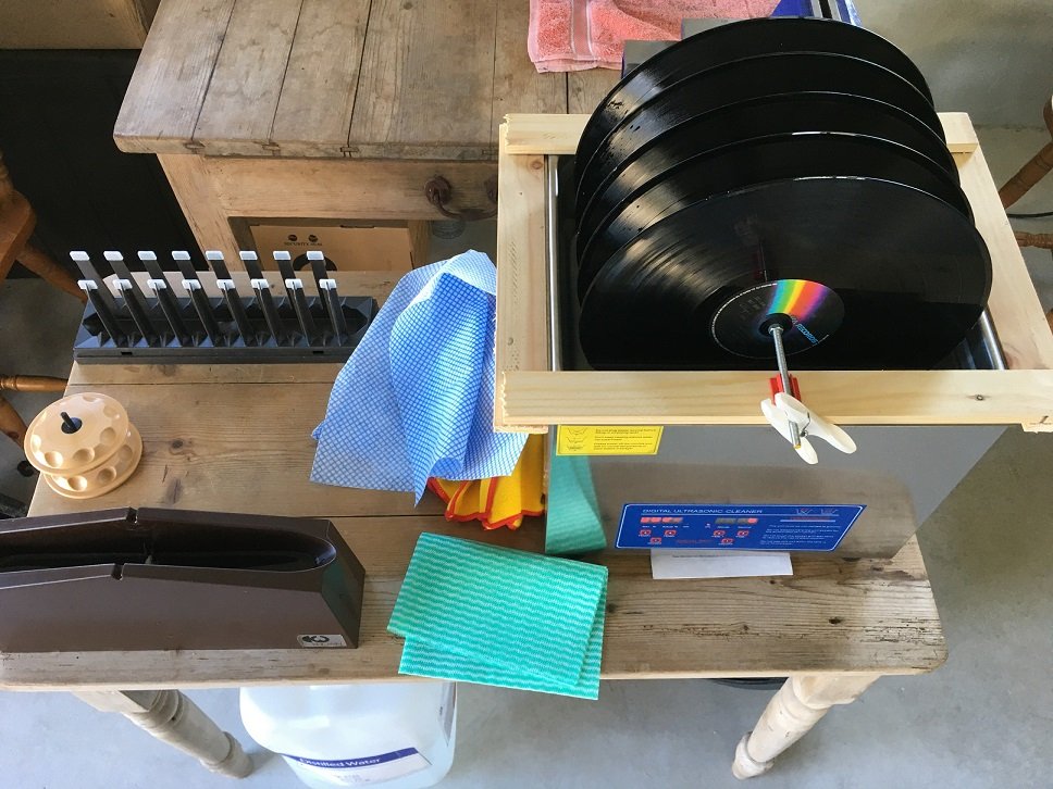

I wholeheartedly agree with Satrus regarding Ultrasonic cleaning. I could never find a satisfactory way to clean vinyl until I invested in an Ultrasonic machine - I fill it with 5 parts distilled water to one part white vinegar. Some of my 70s vinyl was close to unplayable, now almost as new. I never realized that it could make such a difference. I can clean up to five discs at once, although for really bad condition purchases, I'll put one in on its own. I filter the mix every few records, that way it lasts for quite a while. For drying, I use an old but powerful hairdryer set to stun without the heating element - works every time. I'd recommend it.
