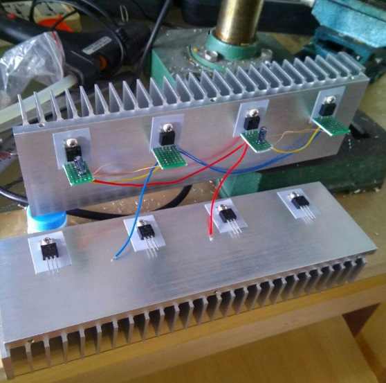

Here's a prototype speaker amp coming together based on the 'hot buffer' concept. Four channels, I'll start by arranging them as two pairs of two for about 7W per channel, then when I have another case convert the first 7+7W amp to a 14W monoblock. The experiment is to test how well the amp case can cool itself, the limit on the power output is going to be how hot the case gets. The 7+7W is based on an estimated 56W total (25% efficiency).
nige2000
Posts: 4253
Location: meath
Re: Mosfet amplifiers including Susan Parker Zeus amplifer
Post by nige2000 »
Ah super cool
Funny how the requirement for heatsink brings out the case
What size are the fet packages ?
Hope it works out so I can get stuck in :)

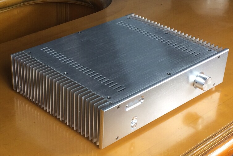

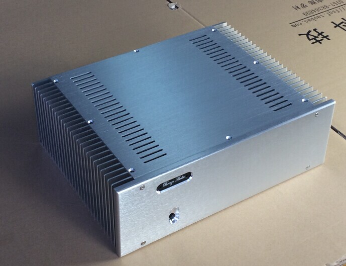

Having trawled around Taobao a little, I came across this case which is 120mm tall (the one I'm building with now is 80mm) so should be able to shift a little more heat.... It also lacks provision for a volume control which is just perfect for a poweramp. The FETs are TO220.
Here's the seller - https://item.taobao.com/item.htm?spm=a1 ... 2142218594

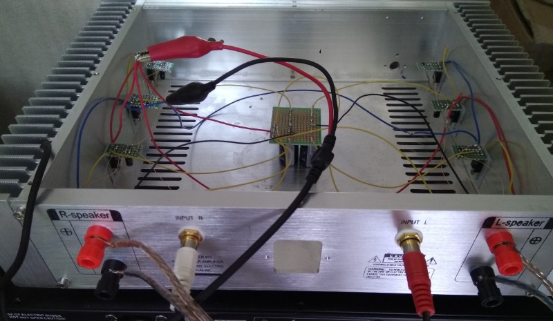

Of all the amps I've built, this one was far and away the easiest to throw together and I think probably the only one that worked first time. ClassA amps with no GNFB are not liable to oscillations (one pitfall for inexperienced amp builders) and also they're relatively intolerant of wiring topology to get excellent sound. So I reckon this amp is a very good beginner's amp for anyone who's not gotten their togs wet in amp construction. Its only a buffer right now, needs a voltage gain stage (about 20dB) which I'm working on. My current design for this gain stage is considerably more complex than the buffer, I'll experiment with a 10:1 step up transformer in the spirit of Zeus.
Just a lash-up at the moment, running from my bench supply (2A, 24V). Eventually I will fit a switching brick inside and the voltage gain module. Even with those added it'll still be mostly air.
