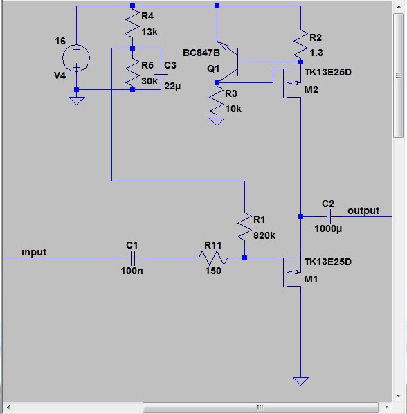

With regard to "headbuffer"it's even simpler than that - it's basically just the same as the class A buffer in that schematic but all MOSFETS - ccs is on top & output is taken from source of MOSFET through a cap.
It's SE class A so no complimentary device needed

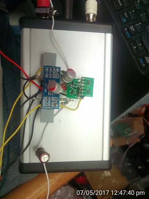

Here's a pic showing the size of this. This is the stereo "headbuffer", 2 channels - the green SOT23 adapter boards are 0.5" X 0.5" & each has a MOSFET mounted - 6 green boards in total - that's the buffer - the rest on the blue board are the passives on the input & output
A number of smd resistors but some through hole caps & resistors as well - it would be even smaller with all smd
https://drive.google.com/file/d/0BzRUtX ... sp=sharing I'm sure suitable changes to that schematic will yield an even simpler design using these MOSFETS?

The I/V transistors (far left) can be exchanged for the J327s in that schematic - the threshold voltage though may be a little bit higher and is certainly more variable than with bipolars. So a bit of tweaking might be needed. Nowadays I run my 1387s on 6V to get the most output swing.
As John was saying the buffer circuit in that schematic (right side) using an EF loaded by a CCS can be changed to a FET (its an NPN so use the K339) and the output transistor in the CCS to another K339. But I've learned a little since I designed that buffer, now I reckon its best to do it with a CCS to positive and a P-channel FET.

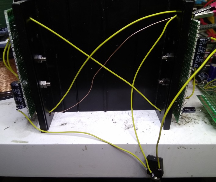

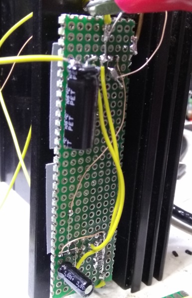

Here are a few pics of the prototype 'hot buffer' (so named because its too hot to pick up, running about 16W total dissipation). Its easily the best headphone amp I've heard, even better than ones using OPTs.
Turns out I can't upload because my files are 'too large' so I'll have to figure out a way to shrink them down. Shrunk and attached :

Yeah I think you'll only lose a very small smidgeon of bass with 47nF in place of 100nF. You can always increase the 820k to 1.5M to compensate if you're so inclined.
The heatsink is 15*10cm with 1.5cm high fins. The FETs are mounted on two 5mm thick 'wings' at right angles to the underside. Its one I think I originally bought from Maplin over two decades ago so I doubt I could find an online equivalent. I reckon you'll need an overall thermal resistance in the region 2-3oC/W if you want the surface to be short-term touchable.
The 500mA bias really is overkill as no headphones are going to need anything close to that output current - what it buys is higher gm (hence lower output impedance, better PSRR, lower distortion) in the MOSFET.
If you're ordering heatsinks from Mouser, these look to be good value and if you put each transistor on its own one you'll be able to up the bias even more than I have : http://www.mouser.com/ProductDetail/Ohm ... 4U4BtvA%3d

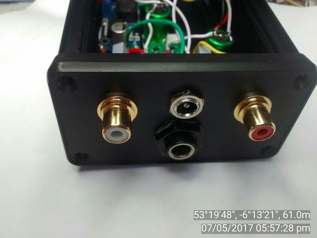

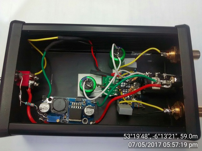

Anybody local who's interested in headphones & wants to try this out - I've one built & cased up for sampling. it's designed for 34 ohm Superlux HD 681 headphones but will drive anything over this impedance of suitable sensitivity.
Remember it's not an amplifier, no voltage gain but nice current gain
Photos here connectors are:
- stereo phono RCA inputs
- 5V input
- 1/8" headphone output jack
