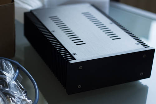

Just a quick update regarding the HD-PLEX Power supply, which is now supplying my NUC. Some initial listening sounds very promising with Oscar Peterson track sounding great. Very hard to a/b as it requires restart and sometimes a swop of USB drives...
Great packaging and seems very well build. Should have come from Germany but came from Hong Kong so 16 euro of duty was due on arrival... Will report back as I listen some more.

Just got a huge ground loop problem! As soon as I connect the USB for the ciunas it appears. I assume it is the added grounding of the NUC power supply that causes the problem, as it stops when powered by a non grounded laptop ps. If any one has any tips I am all ears! Thanks, Claus

I took out all connections to the NUC and it stopped but started as soon as I connected back the ciunas (it is charging from USB on NUC but had no effect). I am sure it is the ground on the new PS that is causing it, but a bit nervous to remove the earthing on this device...

Looks very tidy inside! But I had the exact same problem when using a laptop charger with earth. Am I risking death if I remove the earth on the power cord? Nothing in Denmark has earth so...
