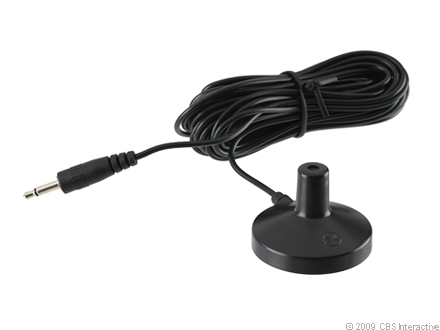

Why not allow the DAC or the CD Player to self adjust its frequency outputs to suit the room that the system is in? Broadly speaking: Place a microphone at the seated position, the DAC outputs a frequency sweep for one speaker at a time and it records the audio signal from the microphone. Using a computer it ought to be simple to examine the waveforms and instruct the DAC to boost or cut frequencies as required. The file with the modifications could be loaded into the DAC by means of a smart card.

I've tried some of this using REW from http://www.hometheatershack.com/ ( join to download) where you connect your laptop to your sound system a sweep through the audio frequencies and using a microphone on the same laptop record the resultant spectrum. Then with REW you make response files that boost or reduce frequencies as appropriate. You can add these to something like HQPlayer or Foobar. I think the trick is to make small adjustments and use a calibrated microphone.

Exactly the same with Onkyo, I think it's the same software.sdiesel77 wrote:Yamaha HomeCinema amplifiers works like this too, they re coming with a microphone to do the setup
