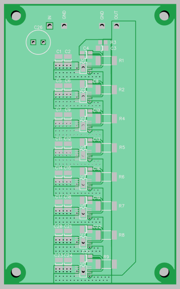

Re: MoBo Memory Power Bypass
Work in progress...
- lt3045-8-3-render.png (95.77 KiB) Viewed 2939 times
even better
