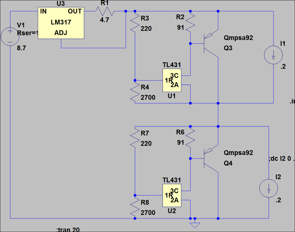

Here is my ltspice circuit I used for the sim.
Basically you stack the regs on top of each other, so you don't need separate ps taps like Nige did for his amp.
Adjust R1 for current you need, and maybe change Q3 and Q4 to larger devices.

randytsuch
Posts: 395
Re: Soekris Dam Dac
Post by randytsuch »
The design as shown was made for 200ma.
Should be enough for any dac. The transistors I used are rated for 500ma if I remember correctly, and the power supply that provided the raw power was probably less than that, so for my purposes 200ma was fine.
Maybe if you were powering an amp you would need more current, but for my purposes this is fine.
And since I have the batteries, they take care of any instantaneous demands over 200ma. As long as the average current draw for whatever you are powering is less than 200ma, this should work fine.
Note that his R1 is a smaller value than what I used. This resistor sets the current limit for the circuit.
Randy

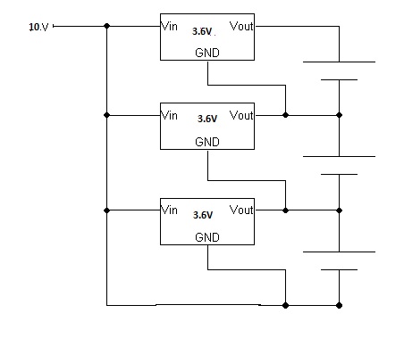

For single LiFePo4 battery you can use charger boards based on TP5000 IC - very low back leakage & no need for switch or relay to isolate battery
Indicator Led to show CC/CV charging & fully charged - 2 Amp CC when used with small heatsink, otherwise 1-1.5Amp & 3.6V max voltage
Using some additional circuitry, chargers could be connected to multiple batteries in series
Search for them on ebay - about $2 from China

jkeny wrote: Thu Jun 14, 2018 9:24 pm For single LiFePo4 battery you can use charger boards based on TP5000 IC - very low back leakage & no need for switch or relay to isolate battery
is that something that needs multiple ps windings for multiple cells in series to provide isolation between each charger circuit supply?
jkeny
Posts: 2387
Re: Soekris Dam Dac
Post by jkeny »
nige2000 wrote: Thu Jun 14, 2018 11:00 pm
Using these TP5000 a simple configuration like this could work (it's limited by the 10V max input voltage of the TP5000 stated in the datasheet although board sellers recommend 9V max) which effectively limits it to 3 batteries - maybe only 2?
These turn off when battery charge reaches 3.6V & if not powered the leakage from battery to TP5000 is very very small - so no worries about discharging battery - no need for relay or switches to isolate battery

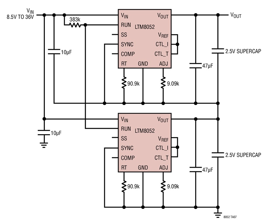

These would also work & they have a 36V input max so good for 10 batteries - LTM8052 but they would need a relay or switch between each charger & battery to prevent back leakage
multi-battery charging 2.jpg (76.74 KiB) Viewed 1951 times
Sorry, that only does 2.5V output - what is needed for one of these voltage regulators is one that can source & sink current - a 2-quadrant regulator
