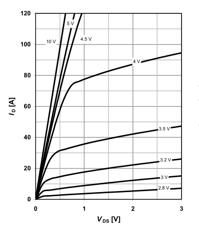

Pretty much all power MOSFETs have that reverse diode between D and S. I took a look at the datasheet, fig5 gives me the heebiejeebies because the output impedance is so low. This means the gm is varying substantially with Vds. I prefer devices with nice flat lines meaning higher output impedance and hence better PSRR.

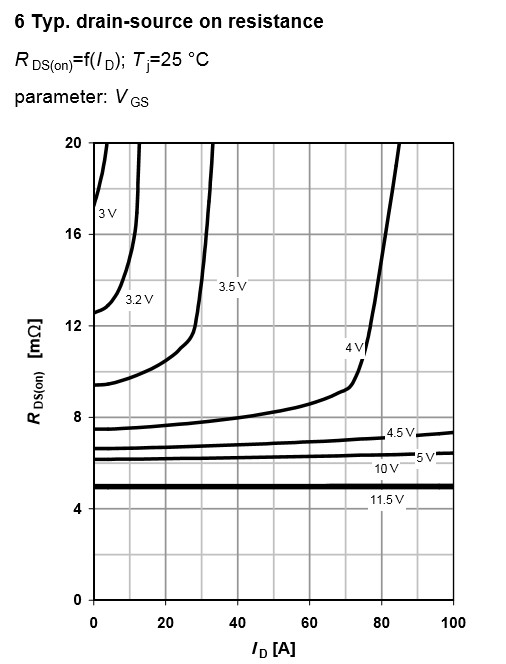

Ok, thanks - Do you mean Fig 6 - this one:
DS resistance.jpg (49.95 KiB) Viewed 1028 times

jkeny wrote: Tue Jul 11, 2017 3:40 pm Ok, thanks - Do you mean Fig 6 - this one:
No, fig6 only shows Rds(on) which applies when the FET is fully enhanced so for very small voltages between the drain and source. I was referring to the Vgs stepped plot here :
Notice that for low Vds the lines look about parabolic but then as Vds increases, there's a kink and the plot then goes east-north-east. That part after the kink is showing the output impedance looking into the drain of the FET. If the line's horizontal, the FET is acting like a current source (infinite Zout) but here there's a very much non-infinite Zout. The output current increases with increased Vds even as Vgs is held constant.
With bipolar transistors there's a parameter called the 'Early voltage' which is related to this. If you extrapolate the sloping lines backwards towards the Y axis and beyond, they converge at a point which represents a negative Vds. The Early voltage of this FET looks to be in single digits volts - whereas a good bipolar transistor will have an Early voltage in the high tens or hundreds of V.

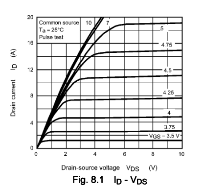

Contrast this plot with the equivalent from Toshiba :
You can see there's a slight slope for higher drain currents but we're operating below 1A (Vgs < 3.5V) where the Zout looks impressively high.
