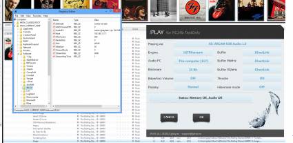

Could you give a sceenshot of your regedit settings as I don't have the xtreamstop time type in mine?

here you go
