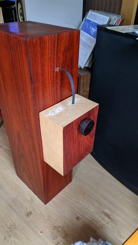

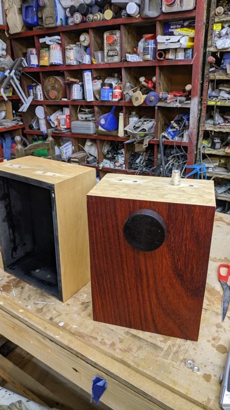

So as I mentioned, I wanted to put the crossovers in a separate box for ease of modding (and many manufacturers suggest that an external crossover can sound better). Maybe in future I'll somehow mount them inside, but for now and probably forever they will be outside. However, I had to decide how to house them and how to do the connections etc. I came up with a system where I put a threaded insert into the rear of the main speaker box, then made a box for the crossover to sit in with binding posts so that this crossover box would be affixed to the rear of the speaker cabinet, but could be unplugged and undone easily. It probably doesn't match perfectly with the fairly neat lines of the speaker, but they are invisible from the seated position, and I can always sit them on the ground if necessary!
I meant to add before, when mounting up the crossover components, I put a piece of copper sheet as the centre ground bar and then ran the HF and LF components either side. I'm kind of a fan of a big low impedance copper sink for grounding, so this just followed that thinking although its probably unnecessary.
I veneered up the MDF boxes to match the colour pattern on the rest of the speakers. This way if I did put them on the ground at any stage, they would look "matched" to the speakers.
There's a little mark on the top in this pic, its just before final finishing of the boxes.
