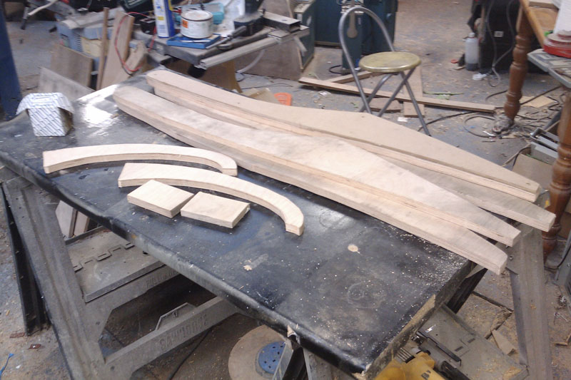

So I got a bit of time tonight and cut out the blanks for the legs etc:
Next now I need to use the templates to rout back the edges. I couldn't find the router bit (typical!) so I might just take the opportunity to pick up a new one.

Routing and test fittings now done. Its onward to sanding and finishing for this set now. I need to get myself some nice replacement woodscrews too, but I think I'll pick those up handy enough.
I think the key thing with these stands is that it will be very easy to play around with the rake. Like burger king, you can have it your way... and its very easy to do.
So the way its shaping up, the procedure to fit these will be easy:
1. Put speaker face down on soft cloth.
2. Remove cheeks and existing feet.
3. Fit new back leg - it will screw in where the old back leg was. fit adjustment spike. Although you won't be reusing the screws or feet, I recommend you put all the screws and feet into a bag for safekeeping.
4. Fit one side leg, bolting through the original quad side cheek, then repeat for the other side. There is an extra screw here - and it is best to drill out a pilot hole for it if at all possible.
5. Make sure all screws are snug and stand upright. Adjust levelling spike so that the speaker has the desired rake. Plug back in speaker and allow to charge
6. Enjoy!
One advantage of these over the Sheldon Stokes ones is that you don't have to take off the back wire grille to fit/remove them. So its actually reasonably easy to reverse the mod.
Pics to follow later.
