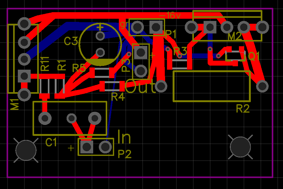

I'm designed a little PWB for the headphone amp.
I think the PWB is done, plan to place an order for a few of the boards soon.
Then I need to order the parts from Mouser.

ye would likely be as well make provision for TK50J30D mosfets on that pcb for the speaker amp as its the same circuit
i'd be tempted get a few boards made myself then
randytsuch
Posts: 395
Post by randytsuch »
nige2000 wrote: Thu Feb 01, 2018 9:41 pm ye would likely be as well make provision for TK50J30D mosfets on that pcb for the speaker amp as its the same circuit
Took a quick look at the TK50J30D datasheet
Looks like a bigger package, pin spacing is basically twice the tk13e25.
So it should not be a problem to put in a couple more holes for this part to accommodate the larger part.

randytsuch wrote: Thu Feb 01, 2018 10:02 pm
yea thats what i was thinking,

here it is, supporting both types of mosfets
Resistors are mini melf type surface mount except R2. R2 is a 3w power resistor
P1, P2 and P3 are just intended to solder wires into
head pwb.PNG (36.14 KiB) Viewed 1321 times
