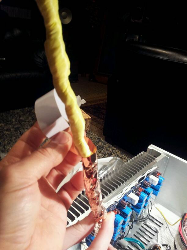

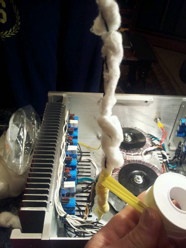

I'm trying to shield the DC wires from Teradak to Zuma. Since on the 24 pin I have all the voltages and all mixed up, I thought to get rid of the "extras" and isolate and shield every voltage+ground separate.
I did one small experiment and I shielded only one SSD DC cable and the difference was kind of very big! Much more that I expected! So I decided to shield everything. I'm still trying to find the best way to do it.
First thing will be simplify then group and shield.

I just did very simple, following some of the Kyrill advices for the cotton and Teflon tape and Stoneman(Andy) for the cooper tape and ground on the main ground(earth) on my Zuma.
