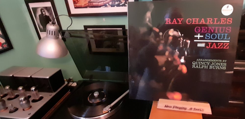

True to my word ... the things I do for you people.... 😀
