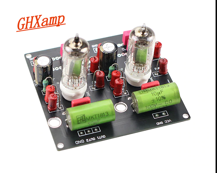

We have been busy prototyping the output stage on this DAC. One of the key sonic signatures of the DAC will be the current to voltage converter and output stage. We have been looking at both valve and solid state options here. I had 2 different stages that I had ordered quite a while back from Aliexpress for messing about with the output of a CD player, so I went to examine could they be used for this DAC as well. The classic one for current output DACs is what is now popularly known as the Lampizator stage - a 6n2 SRPP circuit. This gives lots of gain, is a really well developed stage and the valves are excellent, plentiful and cheap.
The only thing that was needed to get it functional is a transformer with the appropriate voltages. Surprisingly the stage powered up perfectly, is perfectly quiet (always a bonus) although there are a few bits that were needed to make it safe and practical (earthing and a bleed resistor). Sound from this is lovely, theres lots of gain, so volume knobs will be turned down, but its clean, deep, lots of detail and loads of impact.

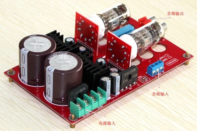

The second curiosity was another valve stage from Aliexpress, this time using a really oddball radio valve from the 40s (and when I say radio, I mean battery powered valve radios from the 40s).
This caught my eye because these valves are directly heated triodes - like those 10Y, VT45, 300B and plenty of others that valve afficionados gush about. The price was so low, and it came as a built unit, it seemed a no brainer. Well, the thing is that from first turn on, this unit has been a struggle. Because it they are DHT valves, the filament supply is critical - get it wrong and you will have hum, and I don't mean background low level type hum either. So I ran it from some batteries to start with, and there was certainly enough promise to make me struggle on. The next bit was to improve my cobbled together power supply. The high voltage supply went to a much improved one, with a regulator system. Likewise, the filament heaters were also regulated, and then there were a few other minor tweaks to wrong the best out of it. The sound here is sublime to my ears and I am very happy with it and tbh, could just box this up now and call it done.

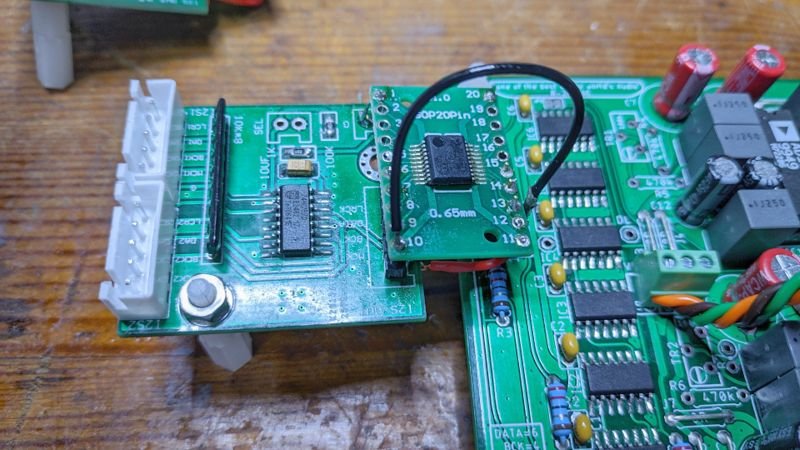

First thing is this version of the Dac although it has valve output is really neat and tidily put together. It is way more simple to look at compared to the groupbuy dac that is packed full of parts. Maybe if the dac is shoe horned into a smaller case it wouldn't appear that way. Don't get me wrong I wouldn't have a clue how to put it together but from working on the other dac (Under instruction) this looked much easier to pull together to my eyes.

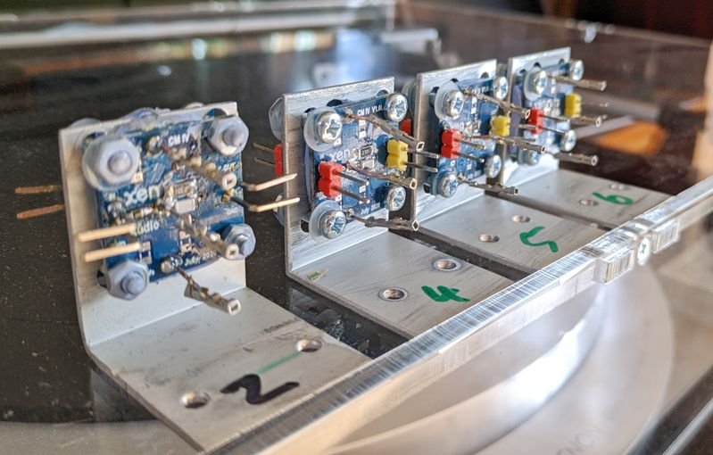

This is another output stage that we have been working on - its a very neat current mirror stage, and sounds excellent in the testing so far (this one was kindly facilitated by a friend over on DIYaudio who is the genius behind the circuit and helped us in making it). In fact its good enough for us to have made one for each of us. The picture doesn't really convey how small it is - the blue board you see on the piece of alu angle in the photo is about half the size of an SD card (about 20mm square). There are 6 dual transistors and 12 resistors on each one. Each stereo pair is then mounted on that piece of alu which acts as a heatsink for the devices - and keeping them all thermally coupled helps keep everything working smoothly. This output stage needs an excellent power supply, and luckily we have that in the DAC already, although we will be looking at options for it for sure.
When its contrasted with the valves, it is just so tiny its laughable - but of any component I've ever had here in the system, this one goes lower than any of them. I didn't think my speakers could go that low.
