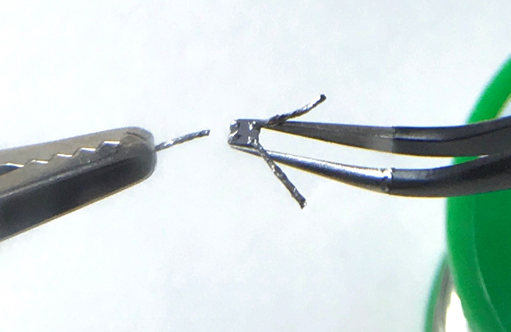

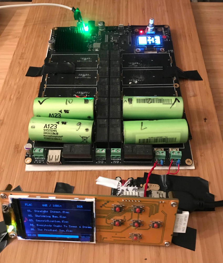

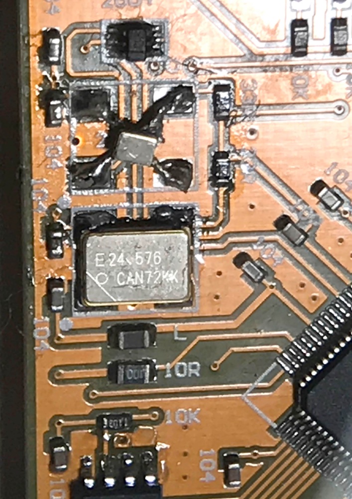

Received the NDK clocks and added the 22Mhz today. Some photos in case anyone needs some help as they are not easy to deal with. Thanks for the tip Pearse, I added the little wires to the NDK and removed the old clock with plenty of rework flux and Chip Quik alloy.
Burning in for a few hours and getting the best sound I've had through my system so far. I've been around the houses searching for all the detail, big soundstage, black background etc you expect with digital but WITHOUT the harshness, which is not easy to achieve in my experience... powering the player with Ian Canadas LifePo4 board... Sounding magical.

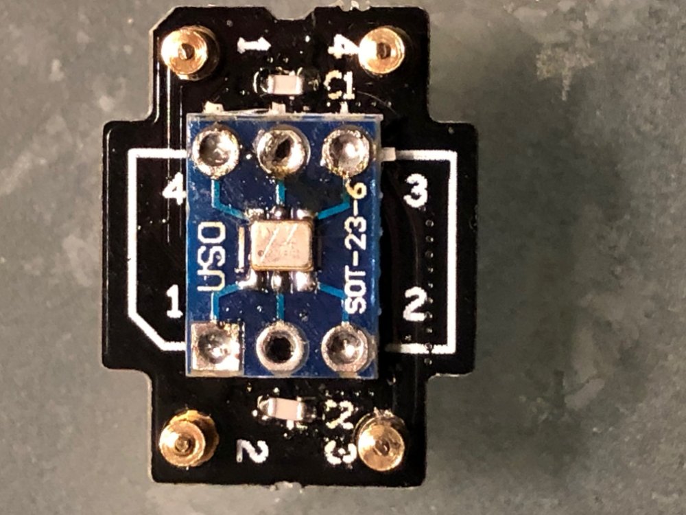

FYI guys, for mounting ndk clocks, I figured out that sot23-6 adapters are a perfect fit
The holes for the sot23 adapter will line up with the pad pattern for crystek's, or you can wire from there if you have to.
I soldered the adapter to the bottom board by putting solder in the hole and pad, then placed the adapter in place and heated up the hole
