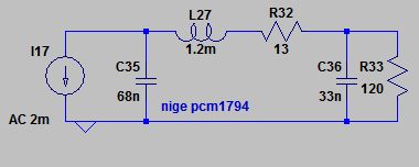

nige2000 wrote: Tue Dec 04, 2018 4:19 pm I've got 2 270s in atm
If I remember right anything between 100 and 150r seemed to work just fine
Here's a LP filter which gets rid of a whole load of ultrasonic stuff. It doesn't do NOS correction - do you need that? It can be tweaked to add some HF boost to counteract the first-order hold function within the DAC. Here I've reduced the I/V resistor slightly as the filter adds extra compliance over a naked resistor. The 13ohm resistor should be reduced by the DCR of the 1.2mH inductor.
To drive a transformer in voltage mode I'd suggest a MOSFET buffer - a current source loaded source-follower along the lines of my headphone buffer. The best MOSFET for this will be SSM3J56 which comes in a very very cute package about 1mm long. The CCS is best built with bipolars as they have lower capacitance.

Dc offsets are circa +/- 2.75v on the differential outputs at 133ohm iv
Think it's either 800 to 1000mv output ac
Am I right in thinking if I introduce a negative supply I can use the same fet buffer on the negative output to drive a traffo without caps?
