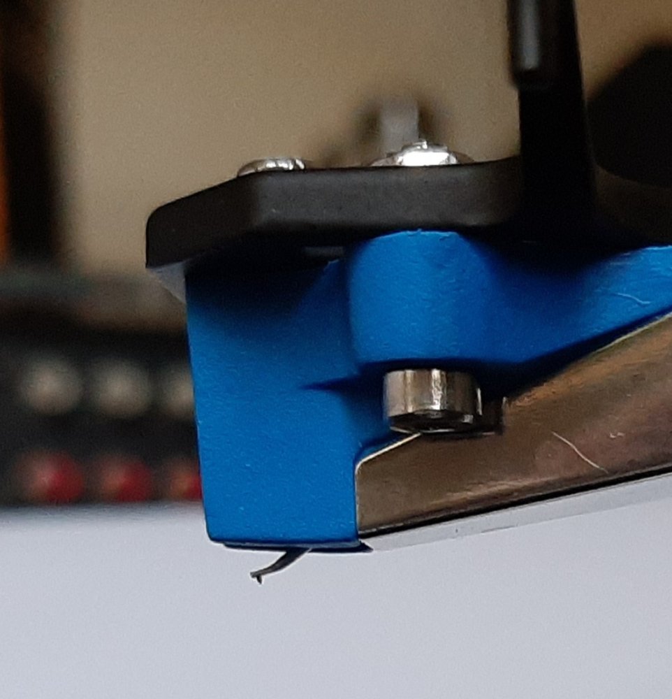

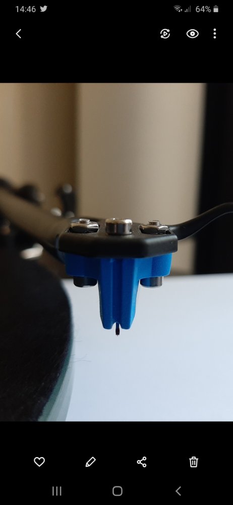

I tried to take a photo of the stylus yesterday but my phone wasn't really up to the task as you can see. Still, I can't help but feel like it's "slightly" off to the right a bit. I'll accept that this could be my eye, it's very hard to tell. There also seems to be a lot of play left to right in it. I'm still convinced it's donald ducked!
