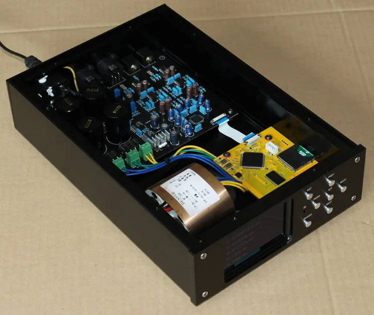

john did u ask wendy

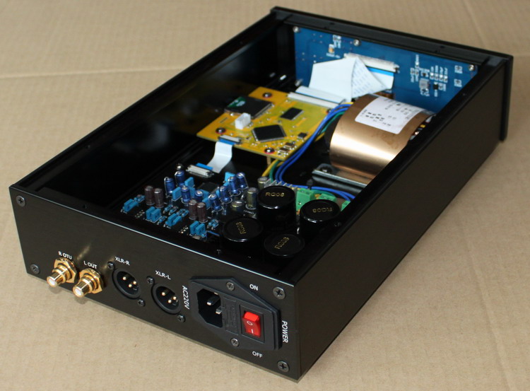

about sourcing these yellow boards that are in the completed unit?
as they look like a better fit for our use
jkeny
Posts: 2387
Post by jkeny »
looking at the pic they seem to have a cable that goes to separate screen module - is that what you mean? We might try order the board alone?
The seller won't consider any non-stock sales unless 50 or more - I guess if the boards were cheap enough a buy of 50 wouldn't be too bad?
I'll ask

Well I was Thinking
We don't need the screen
we don't need the buttons on the unit
The screen and the controls are detachable
Would be a more manageable size to fit in a case
I was also hoping the yellow boards without screen could be 20 usd or less

Yea, that's my thinking too but doubt the seller assembles these & has individual cards - also what minimum sales value he is likely to be interested in?
