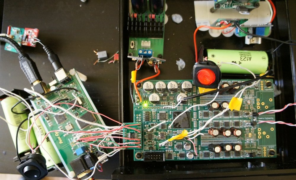

by wushuliu
Hey Nige, I opted for the BC550/560 mod on the vref opamps. Not going to try the Lifepos there, too skittish. But I am trying to decide if its worth removing the +/-5 regs.
Currently running +/-9v from a two stage PS:TPS47whatsit reg-->Lt3045s-->Dam. I can modify it to supply the dual 5v to the reg pins if it's worth doing. What do you guys think?
Here's a current pic of the build:
Modded Soekris 1Small.jpg (200.91 KiB) Viewed 14003 times
