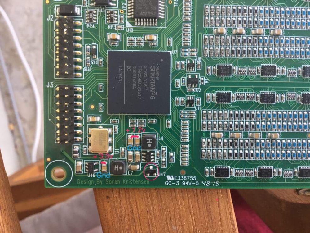

Hello everyone,
I want to make the 1.2 and 3.3 ldo upgrade on my dam1121. If i remove the stock regulators, it is correct to tap at the marked points to supply the board with 1.2 and 3.3v? After the mod, do i still must supply 5v vcc5d at pin 1 and pin 2 of thej2 header? U47 seems to be impplied in the muting circuitry(maybe) and is connected to pin 1 vcc5d. Are there anyother parts supplyed with 5v?
Best regards,
Bogdan
Ps: More is written about the 1021, but poor or none regarding 1121. Maybe with our sustained effort we can do a little more documentation about this little board.(eg clock upgrade, output capacitor, vref transistor mod, etc)
