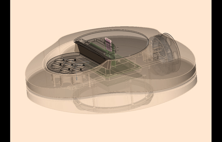

Also to be fair, I don't think they are taking others stuff and re-purposing. Lots of other companies out there doing that of course. Looking at the 6 Moons pix, there are two outline drawings like this one -
which bear no resemblance to the Chinese SD Player PCBs and they do say -
We've been busy re-vamping the entire schematic because we decided to add some features which necessitated moving some things around on the main circuit board. And because we already had everything calculated to shortest possible signal paths, it became another huge project to redo the entire schematic.

I, too, was very disappointed we saw nothing of the innards of this mystery player. We did not see much of the outside other than push buttons in a heavily cropped picture. One of the worst articles the magazine has ever published. No question I doubt many here go to 6moons to read the prose. It is the pictures and I have been very grateful for them.
