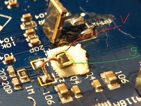

btw. this look okay for the 32khz wiring? ive got clk output soldered and about to do the rest...

wushuliu
Posts: 180
Joined: Tue Oct 22, 2013 2:24 am
Re: Lossless SD digital Player is computer audio now reborn?
Post by wushuliu »
32khz

nige2000
Posts: 4253
Location: meath
Post by nige2000 »
Sometings not right there
vcc is diagionally opposite gnd and clk output diagonally opposite pin1 OE
wushuliu
Posts: 180
Post by wushuliu »
nige2000 wrote:Sometings not right there
yeah i drew that wrong. vdd is opp gnd. my main concern was wether clk output was correct...
