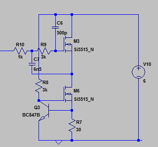

NOS droop is something mathematically defined - because the DAC puts out 'stair steps' the HF response gets 'rolled off' due to the width of the 'stair'. Narrow 'stairs' (such as you get with more oversampling) give progressively less and less roll-off, which is why its only really an issue for NOS - because it has the fattest 'stairs'. The effect with NOS is about 3dB roll-off in the high treble region. With 2X OS its about 1dB and above that, virtually negligible.
I am guessing that the reasons NOS is dismissed have to do with the complexity of the output filter? In my most recent experiments with TDA1387 I've found it sounds better at 2X OS than NOS, which is rather handy for the output filter (it can do a text-book perfect job with only 3 inductors) but adds cost from needing a digital filter.
Here's what I use for NOS droop correction - its essentially a Sallen-Key 2nd order low pass filter with a higher Q than normally seen in order to give a boost at the corner frequency. Its designed to be fed from a 2k I/V resistor. The output is taken from source of M3.

what are these fets k339s or k35's
whats the value of c7?
will the soekris impedance 625z have any effect on that circuit or can it be applied as is?

nige2000 wrote: Fri Sep 15, 2017 8:53 am what are these fets k339s or k35's
As drawn (with 20mA bias) its better suited to the K339s. If you wound the bias down (under 10mA) then K35s could be used.
C7 is 6.5nF
Sure it will have an effect - 625ohm output impedance is significantly lower than 2k so you should increase the 1k resistor to 2k4 to compensate.

can u clarify why this below is not a good idea again
it uses the existing batt supplies was my thinking
abraxalito
Posts: 230
Re: Soekris Dam Dac
Post by abraxalito »
If you want to keep the power supply ripple as low as possible you need to pay attention to where the output current flows. Return it to the +ve supply and you'll see there's only a CCS in series with the load, meaning constant current drawn to the limitations of the CCS. You can watch the supply ripple in LTS just put some series resistance inside your voltage sources.
