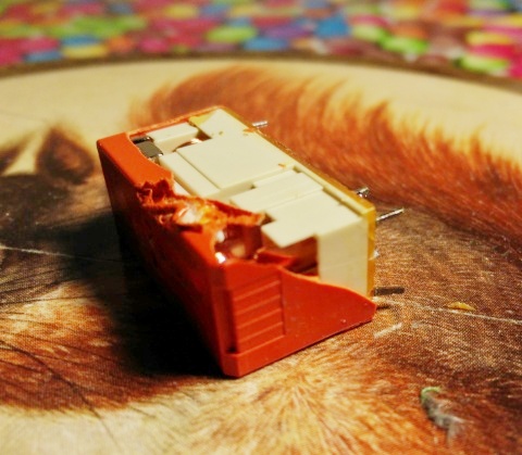

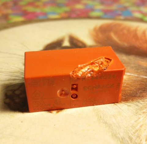

And I have the 3 thats here with me sorted out now. One was due to a damaged relay - it got a bit of a touch of the soldering iron, that melted the case, melted plastic was touching the contacts and stopping them closing. Even though the solenoid in the relay was clicking, the switch contacts weren't making it. You live and learn.
That means 6 working now, last few bits are now needed to finish them off. I'll give these ones here a good soak test, the one in Derek's already has this and I think Nigel's ones will get the same.
