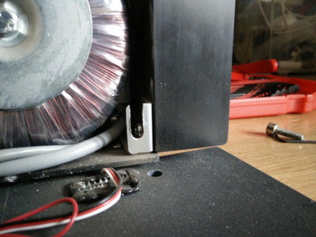

another pic
A very small update - there were 2 front panel bolts that are impossible to reach due to transformers and wiring in the way. Found a simple solution - one of those why the hell didn't I think of that before things. 2 mins with a dremel and the job is done.
I'm hoping to have a look at signal ground to mains ground later today.

cool solution,
i often wonder why it takes so long to figure out these type of simple solutions
when in hindsight they seem to be obvious
I know. Of course what I neglected to mention above was that I had already tried twice to silicone a nut in place, and then epoxy, and the air might have turned slightly blue as neither would work. Its not like the front panel can slip upwards either as the top 2 bolts are still captive.
I also tricked about a bit connecting signal ground to mains ground - no observable difference with the few sources I have here.......
