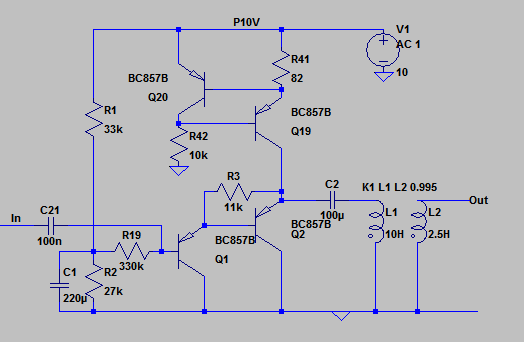

Here's my suggestion for a buffer (i.e. unity gain stage) to drive the cable.

abraxalito wrote: Sun Feb 19, 2017 2:46 pm Here's my suggestion for a buffer (i.e. unity gain stage) to drive the cable.
recommendation for cap types?
not with you with the transformer? can u elaborate ratio etc?
what voltage in and out is

rickmcinnis wrote: Sun Feb 19, 2017 4:58 pm
Is there some kind of selection one must make for the transistors?
Nope, just pull them off the reel.
Is there an available transformer you can recommend?
None I have experience of no as I always make my own. If you're up for making your own something about EE25 sized should work fine. If you want to buy one I'll dig out one or two Taobao links as the guys on a classD thread found some promising ones.

nige2000 wrote: Mon Feb 20, 2017 12:22 am
The input cap is best an NP0 1206. That's what I use anyway. The rest are electrolytics and I'm not fussy about those in signal circuits (power supplies is another matter though).
The transformer is really up to you for the ratio you need. It needs to match the maximum output of the DAC to the maximum input of the amp. I'm assuming you're still using the TVC on the output of the amp.
