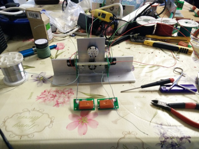

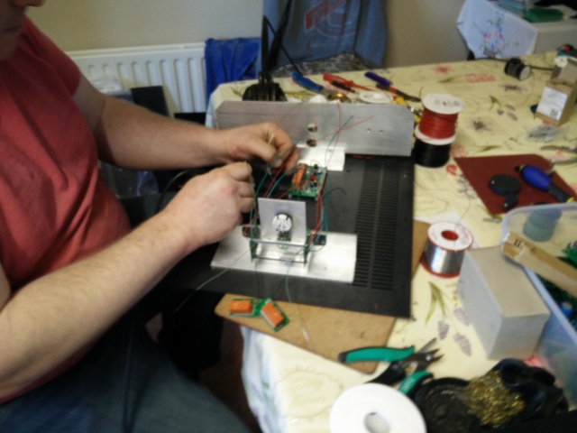

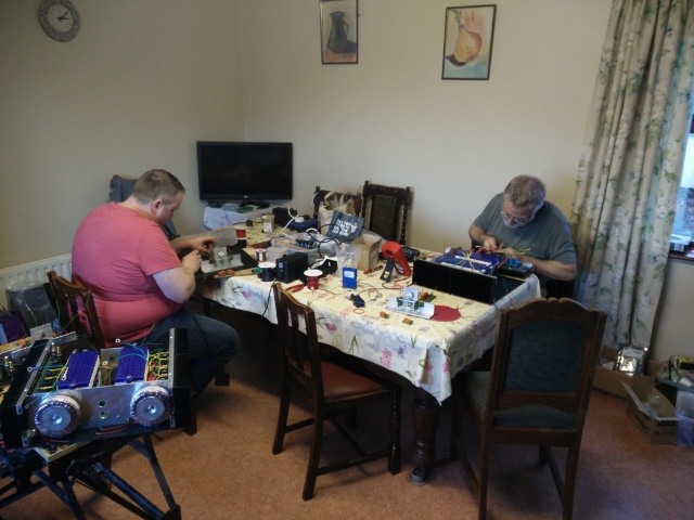

Got another bit done yesterday.
I don't know what Fran and Nigel were up (a lot of very thin wire and soldier) to but I got to drill and tap some more holes.
I'm beginning to feel quite at home in Nigel's shed.
Many thanks to Nigel's Mam, his wonderful Mammy seen us well fed.

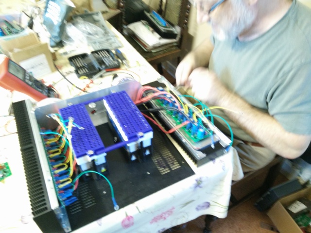

A few pics....
A fair bit of internal wiring done, a fair bit more to do. Its coming together nicely now.....
