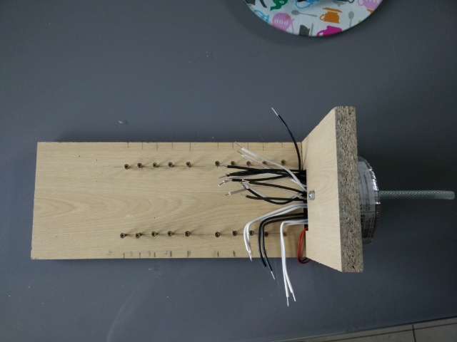

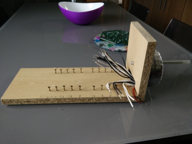

I made up a quick little jig to help with the transformer loom. It allows us to neatly extend and form each secondary for where it needs to enter the power boards. We'll see how it works, and we can knock another one together for other wiring.

Cool
You could mod that to use as a PSU test bench too
Hadn't thought of that. If the regulator boards were fixed on the aluminium you could sit the transformer on, have your leads extended and sheathed and power on to adjust voltage before the rest of assembly. Now more convinced than ever we should use something else like this for the rest of the wiring when we get that far. We'll never get it neat otherwise.
