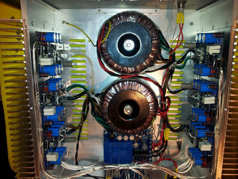

Area i'm interested is: USB flash drive. Where you source USB plugs/sockets, you use for "inserting" external power? Or you use some raw intervention, as i can not see it very clear there :)?

I use modified adapters like this disconnect the 5v pin from mobo and add in external
Lifepo4 for clocks is pretty much essential
Replacing the 32.768 clk is good too

nige2000 wrote:Image
Had found a source for such adapter, so i'll give it a try.
Have some LIFEPO4's, but without tab welds. I'll see if i'll be able to weld some wires on bare cells :)
