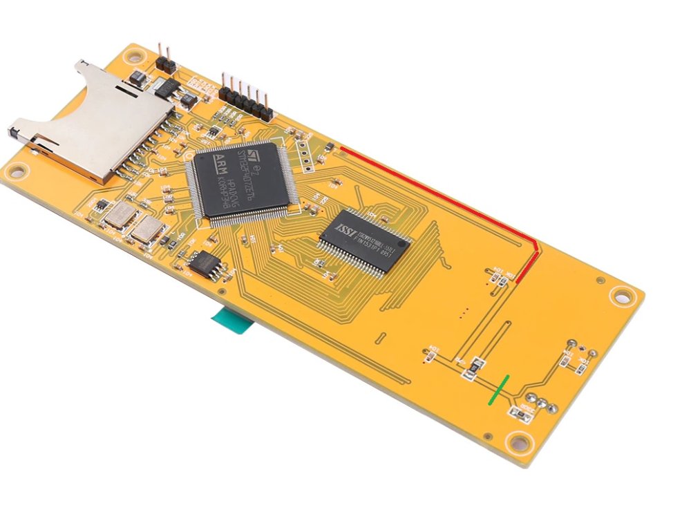

Any chance you could post a pic of the switch implementation?
NUML0G
Posts: 12
Joined: Wed Jan 15, 2020 5:46 pm
Post by NUML0G »
Fran wrote: Tue Jul 28, 2020 9:58 pm Any chance you could post a pic of the switch implementation?
You mean a switch for the display?
It was only a cut trace to test it so far.
All you need to do is cut anywhere along red line and add a switch between the cuts, if you want to keep IR sensor and indicator LED you would need to make another cut at green line and feed the power there with a wire as they get power after the display.
Also know that it needs to rebooted to get the display to work again after its repowered
