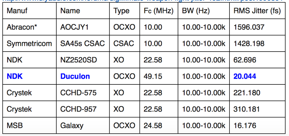

seeteeyou wrote: Mon Dec 23, 2019 1:09 pm Thanks Pearse and Patrick for your updates, I'll keep an eye on this thread.
There's something else I'd like to know as well, someone in Taiwan actually spent almost 5500 bucks / 5000 Euros (600,000 yen) on some kinda Ian's FIFO DAC
http://www.my-hiend.com/vbb/showthread. ... -HI-FI電腦訊源(連載)&p=240486#post240486
Somehow they're assuming / believing that for whatever magical reasons, merely throwing Ian's FIFO into the mix would achieve that "Holy Grail" called source immunity. Did that stuff sound more like unicorn or something? Everyone should be looking for such creature in the wild but it's nowhere to be found. And then the funniest part should be paying VERY good money for a megabuck product while getting a pair of cheap TCXO in return, not even OCXO or anything like that. Dude, maybe they could very well have that "legendary" DuCULoN for burning such serious cash.
I still recall that Patrick should have tried quite a few clocks on Ian's FIFO before, it's mission critical to get the best clocks one could afford since they're playing such an important role. I just couldn't stop laughing when those clocks were put under the spotlight. If source immunity were actually a piece of cake to achieve, Patrick wouldn't need to try so many different sources over the years.
!! 5000 euros on a FIFO hybrid, better to buy from Ian :)!!
I think I might have got this from one of your posts @seeteeyou
Screen Shot 2019-12-23 at 16.25.59.png (205.1 KiB) Viewed 2891 times
Compared to the cost of the Duculon ($1500?) the NZ2520SDs (dropped into the SD card) are a real bargain and the best clock I have used to date.
