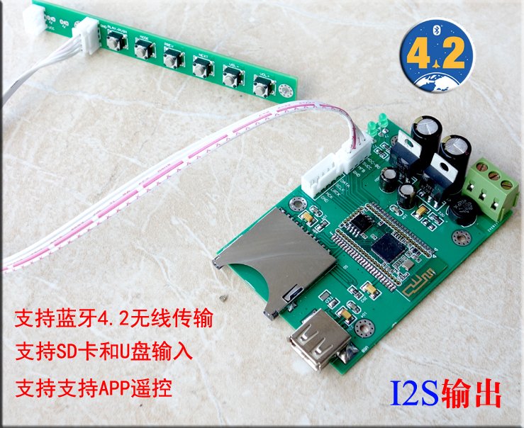

Here's another Taobao offering which is considerably cheaper : https://item.taobao.com/item.htm?spm=a2 ... t=6#detail.
This has no screen but does have a downloadable APP (Android/iPhone) which gives access to the music on the SDcard and also on your phone. Uses Bluetooth - and has in-built digital volume from the wired 'remote'. The APP includes a simple graphic EQ. Can't be beat for the price. Only downside I've found so far is it only supports up to 32G cards - I tried a 64G but that didn't work.
