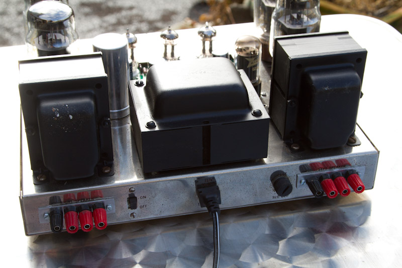

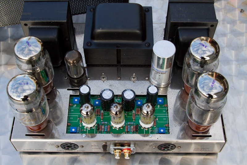

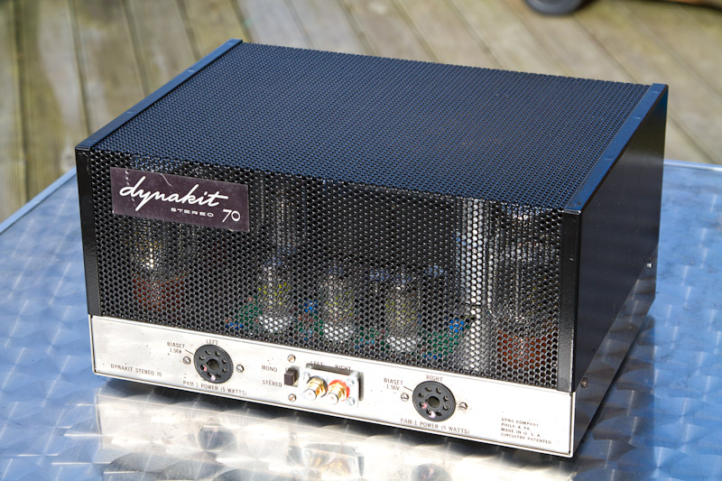

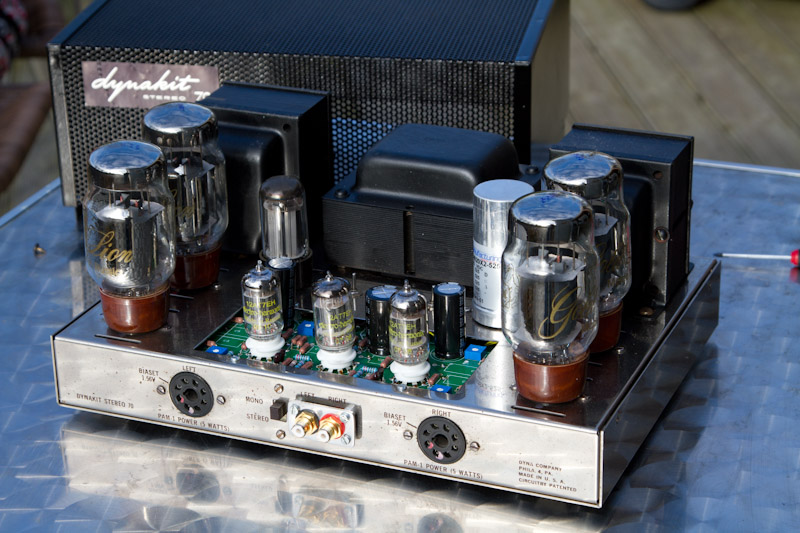

I got the rebuild finished this morning and hooked it up to the test system in the workshop. Thankfully no smoke ensued!! Anyway, here are a few pics..... listening reports to follow in a while, but already I think I'll be happy with this one for a while.
- IMG_1113.jpg (133.81 KiB) Viewed 1379 times
- IMG_1112.jpg (184.61 KiB) Viewed 1379 times
- IMG_1111.jpg (179.41 KiB) Viewed 1379 times
- IMG_1110.jpg (216.52 KiB) Viewed 1379 times

She scrubbed up well although there is a good bit of pitting on the Chrome - mostly that will be hidden by the cage in normal use though. The cage was originally brown but I couldn't find the right colour so decided to play it safe and went with black. Bias is very stable and she is dead quiet, no hum etc.
Sound is very smooth but yet has plenty of dynamic stomp. I've only tried the 16 ohm taps so far - a subject for more experimentation. I also wired in some switches to allow me to run it in triode mode, again yet to be tried out (only verified that it was working so far). Plenty of gain in it too so I'm using it with the pass buffer at the moment.
