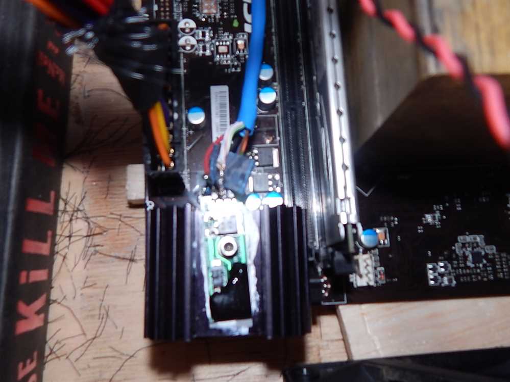

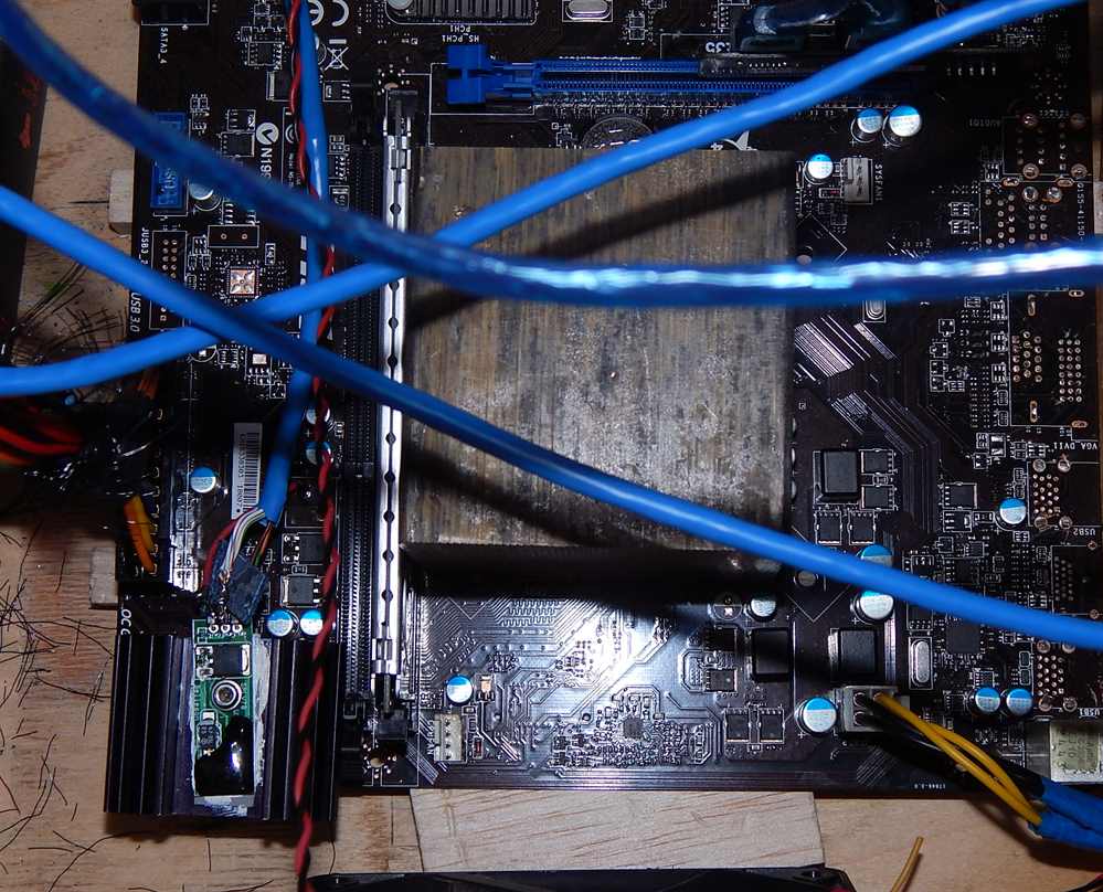

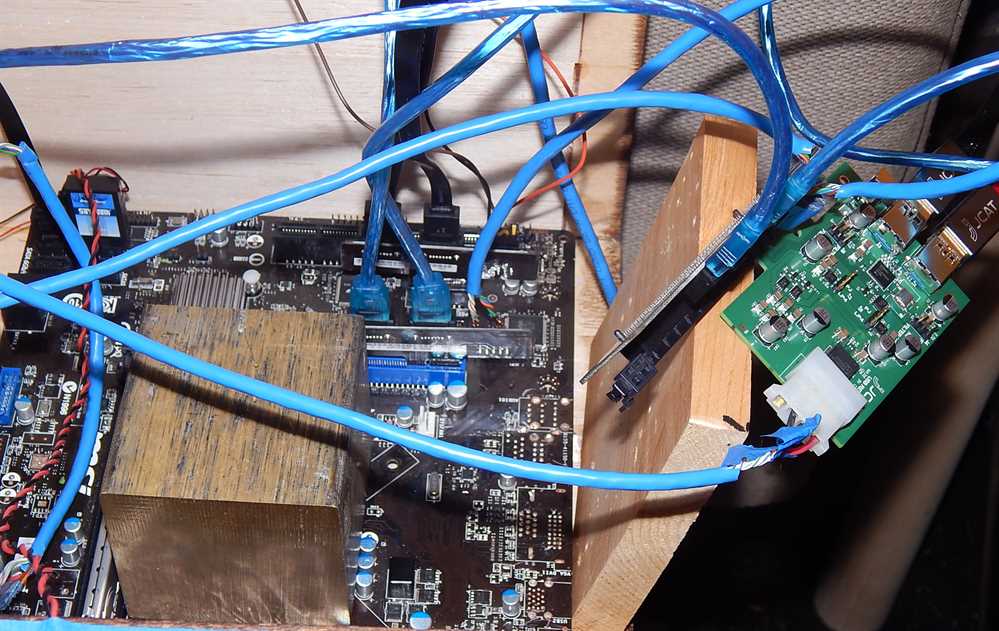

A few pictures of the memory power regulator.
Tried the 1 meter SATA cable between the riser and the board - can't say I heard any difference but it probably doesn't hurt getting the USB card away from the board.
Need to come up with a better way to suspend the USB card.
Took so long to do the regulator install I did not get a chance to get out the heat gun. Will get rid of USB3 stuff this weekend.
Tried the 1 meter SATA on the SSD and it was not recognized - strange?
