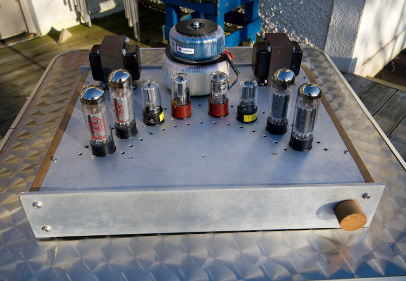

Yes, from the workshop......
El34 in push pull triode mode driven by 4 x 6sn7 for input & drivers. When I had the el34 in the dynaco st70 I thought they sounded overly warm driving the quads, but in this amp they are lovely. I can also do a straight swap and try some kt66, kt77, kt88 or 6L6. Xmusic have 6L6 for 40 a matched pair so I might just try them. The amp is very dynamic, seems like it has gobs of power and yet has the finesse and sweetness in the treble. A very good result for a junkbox build. Willsandbills - they're your JJ EL34s, and Rocker: thats some of the makings from the dead WAD amp you donated this way....
The circuit is the bigger brother to the one used in the el84 amp I built in the baking tin....
I need to make a cover for the transformers....
Sounds familiar! Does it sound... familiar?
Like McDonalds I'm lovin' it....
As per usual it looks the biz. Whens the next meet up? I will have to figure out how to make one of those. If there were no electrics or soldering I would be having a go! I wonder when John will bring out a battery version?
mmm, 500V under the hood..... no go pokey the finger in there! First turn on is always interesting!!! Best go learn on a chip amp where the voltages might cause a flash and bit of smoke but not death.
The amp is in stability testing at the moment...... a soak test if you like.
Sorry for the OT everyone.... back to our regular programming....
