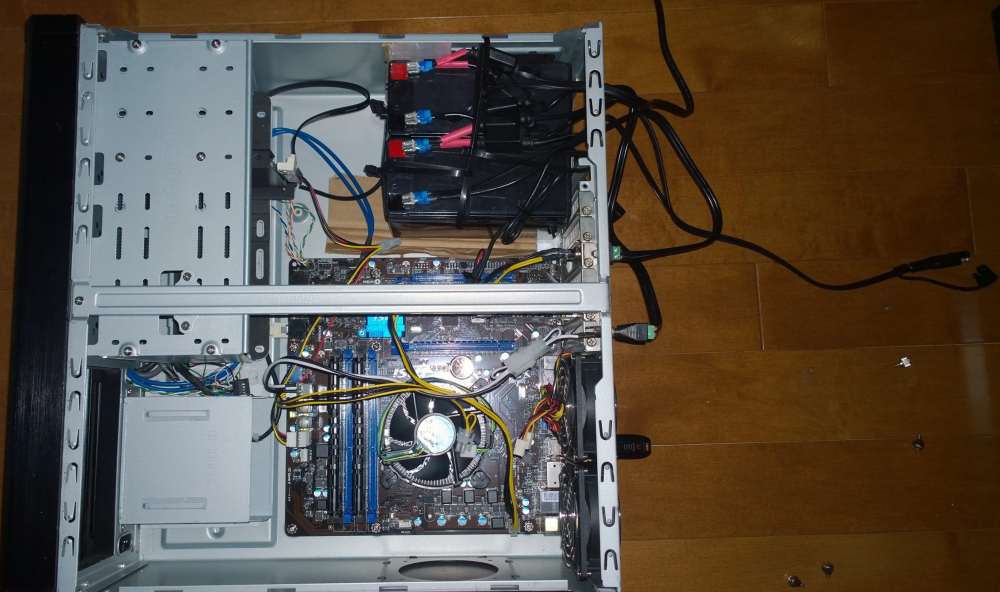

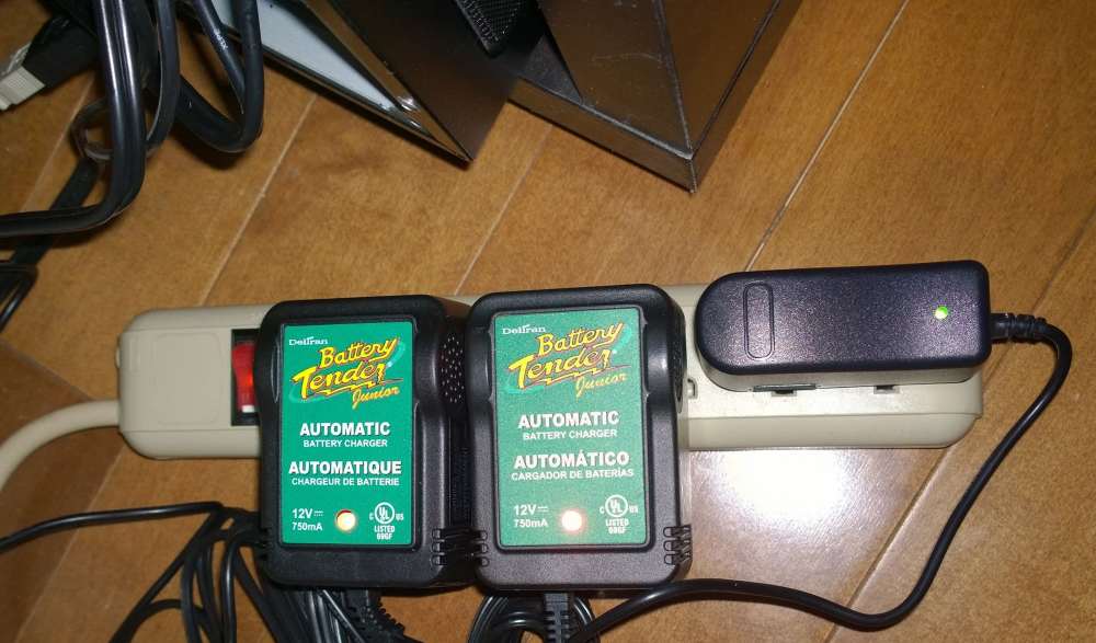

It is time to put some pictures of my new audio PC. I wasn't happy with the size of the box, it looked huge to me with a few items in, but at the end it worked well. I could place two 12V batteries in, so the boss is happy too. I was already asked two times if those will be on the floor all the time during testing mission. One photo shows my charging station, which I turn off during listening, otherwise it turns on.
Very happy so far!
i3 Haswell, PPAStudio USB3 card and USB Micro cable/Chord Hugo/Nad-275BEE/Harbeth-30.1

Looking good , George, you know this is the start of the slippery slope. You could try disabling all the fans and leave the top off the case, works for me so no mechanical or electrical noise.

Ken Moreland wrote:Looking good , George, you know this is the start of the slippery slope. You could try disabling all the fans and leave the top off the case, works for me so no mechanical or electrical noise.
None of the fans are plugged in...they are dead symbols of bad PC design...LOL

difficult to see but have you wired the 4pin cpu plug direct from battery?

nige2000 wrote:difficult to see but have you wired the 4pin cpu plug direct from battery?
is the linear supply not a runner?
Yes I did...I should've done better job arranging those cables before I took the picture, to make it less confusing. The cable with 4pin molex, coming from pico is vacant, but the other one coming from the connector facing outside of the box is connected and supplied by one of two batteries.
The other thing, that is hard to see from photos (resolution had to be slashed down to be able to upload), is that those Tender Chargers come with 7.5A inline fuses. So, I did rearranged wiring little bit with adequate terminals, and I changed those fuses with 2A. There are 4 in total, if you pay attention, they are on top of the batteries. Each charging line has one, and each load feed line has one too.
The small charger on right side is used to charge Anker battery which feeds PP-USB card.
