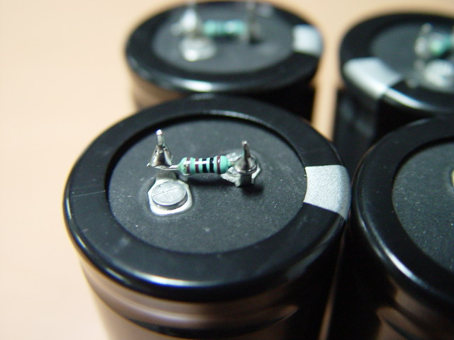

@jrling - thanks for the report - what wattage 1K resistor do you use between caps? I presume this has to be sized according to what instantaneous current is likely to be drawn. I've seen reports of series Maxwells without these resistors holding their balance?
The bleeder resistors are 1/4 watt in my set-up. The current flowing through is tiny as the cells should be in balance all the time. I did it because I was advised to do so by an expert and it gives peace of mind. Out of balance serial Ultracaps could be v bad news and definitely not good for SQ as they would be fighting each other.

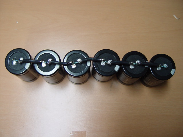

@jrling - are you using 1K resistors across the caps as in this diagram?
www.Ciunas.biz
Re: Battery Power Supply
jkeny - mine are in a case and quite a long process to take a picture that would tell a thousand words.
But this is what I copied (with 5 not 6 Ultracaps in series)
Hoe that answers your question. It works perfectly.
Jonathan
Jonathan

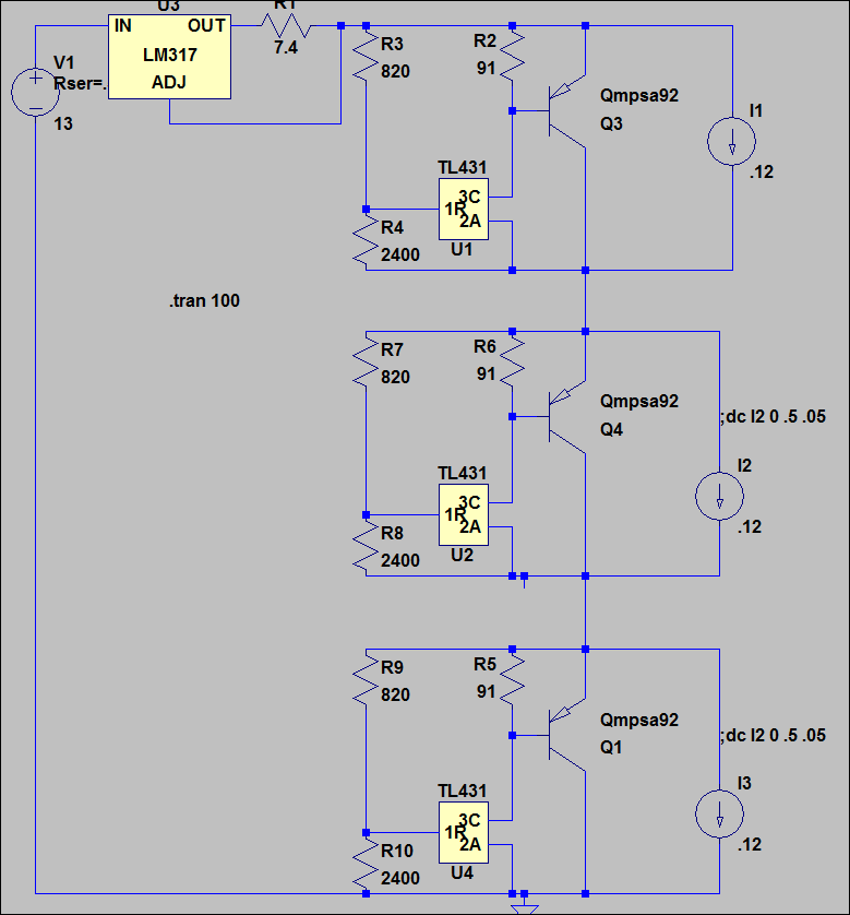

Attached is a little board I built to charge three batteries, provides 10V and 120 ma.
Should provide a little more current if needed, the 7.4 ohm resistor sets the 317 to provide 160 ma.
With this circuit, if you provide at least 13VDC to the 317 input, it will charge three batteries in series at 3.3V each.
You just connect the batteries up in series, connect the ground point to neg of the first battery,
Q1 emitter to + on 1st battery
Q4 emitter to + on 2nd battery
Q3 emitter to + on 3rd battery
I used a 4 pole switch (just needed three) between the transistors and batteries, so I can keep the batteries from draining if power is not provided to the 317.
Circuit has a kind of class a aspect, with the 317 connected like this, it always draws 160ma of current. If there is no load, then this current goes through Q3, Q4 and Q1, and I used MPSA92's in a pretty small to92 package, so they get a little warm. First version I had a smaller R1, so it drew more current and the MPSA92's got a little too hot for my liking, so I adjusted to what is shown.
BTW, if there is a load to draw the current, then the 92's will stay much cooler, but I wanted to make sure it works ok either way. Whatever the load draws does not go through the 92's.
For more current, using a PNP transistor in a to220 package should work. If you heatsink the to220, should be able to get as much as you could need.
You might also need to do something with the 317. It does claim to be able to put out 1.5A, which is quite a bit of continuous current.
The nice thing here is the batteries will take care of instantaneous current, you just need to make sure you can supply more average current than is used.
This is being used to power a DAC, a ling DAC designed by Richard/abraxalito
