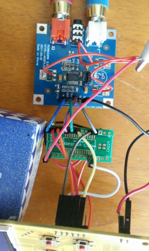

After a few false starts she's sounding good after reclocking. Problems so far have all been with my SMD soldering techniques but I'm improving and learning loads.
Need to start testing now with higher res files than 1644 etc and other dacs.
Huge thanks to Nigel for the education in the ways of SMD

Sorted What's happening with the STM system clock - just needed to read the datasheet, duh - there's an internal 16MHz oscillator which acts as system clock when no external system clock connected.

Well found John.
I pulled that AS1117 reg off the board too and connected both pads back to 3.3V supply. I do think it adds another bit of clarity. Very happy at how the combo is performing now.....
