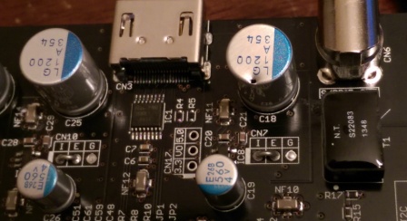

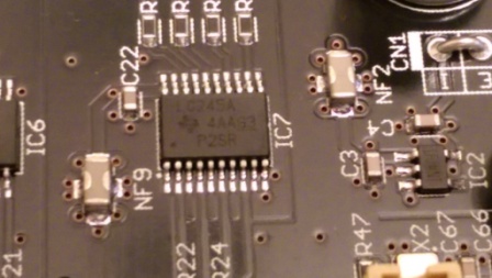

randytsuch wrote:From the picture on page 1, I think IC1 is the I2S to LVDS converter, since it is right next to the HDMI connector (unless I am looking at it incorrectly)
So, it seems you should be able to remove IC1 (or 4 the LVDS converter), and IC6 at least. This assumes you only use I2S directly from the SDTrans.
I might also try bypassing IC7, and see if it sounds better without IC7. If so, you could remove that part also.
Randy
Randy, you are correct, it is the IC1 that is the LVDS converter... see picture. Sorry!
If it were me, I'd first try un-powering the S/PDIF & I2S output chips by pulling CN7 and removing the I2S series Rs from the FPGA... looks like R22-R24 for the I2S lines, not sure on the clocks, probably R40 & R47 coming directly from the clocks. Then get I2S from the input pads of those resistors. That would do the same with the least amount of component removal... though it would still leave the feeds to the S/PDIF and LVDS chips active. Rather than remove them, I'd suspect if those of us interested approached the designer for a custom ROM that would not output to the S/PDIF & LVDS chips, he'd do it (for a price, but that should provide additional benefits).
Based on what both Rick and Adolfo wrote, I suspect mine needs more run-in as my still-stock SDD being fed via an R-Pi is more tuneful than the also stock one being fed via my SDTrans. As I've also got more music transferred to SD cards now, it'll go back into a system!
I2S driver
I2S driver
IMAG3609 - Cmprsd.jpg (48.07 KiB) Viewed 2457 times
Note mine came with the damaged cap... an easy replacement!
