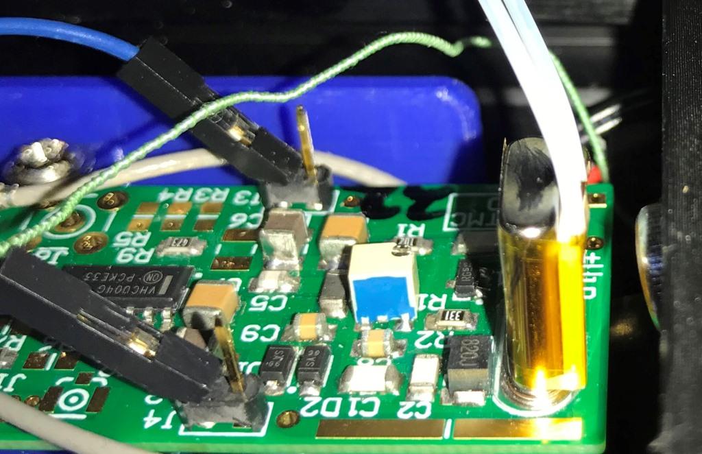

I found some small ceramic heaters on Amazon and bought a few, they have worked very well for heating the crystals and make a big improvement in sound....bang for buck is amazing.
https://www.amazon.co.uk/HALJIA-Ceramic ... 3EKX92VP9R
Have it running off 3.3v Lifepo4 battery at the moment and it holds about 70C on the crystal with a wrap of Kapton tape, a regulator at about 3.5v should bring it up to about 80C.

Sligolad wrote: Fri Oct 25, 2019 8:20 pm I found some small ceramic heaters on Amazon and bought a few, they have worked very well for heating the crystals and make a big improvement in sound....bang for buck is amazing.
Nice, now I really want one lol. I actually have one of his original boards and the first crystals he offered, maybe I'll go ahead and build it up.
If you put some insulation around your crystal/heater, should make it warmer, and keep the temp more consistent. Cutting up strips of Styrofoam would work. Even duct tape all the way around would help a little.

randytsuch wrote: Fri Oct 25, 2019 8:47 pm Nice, now I really want one lol. I actually have one of his original boards and the first crystals he offered, maybe I'll go ahead and build it up.
They are good....i got mine on the secong GB in early 2017 and they had been sitting around since!!
randytsuch wrote: Fri Oct 25, 2019 8:47 pm If you put some insulation around your crystal/heater, should make it warmer, and keep the temp more consistent. Cutting up strips of Styrofoam would work. Even duct tape all the way around would help a little.
I added a couple more wraps of Kapton tape and now temp is at 78C measuring on the open top of the can. So i think i will just add some tape across the top to seal it completely and i should be good at about 80C.
Sound is great just as it is and I always knew good clocks with good power supply were important but these take it to a new level of importance of digital playback.
