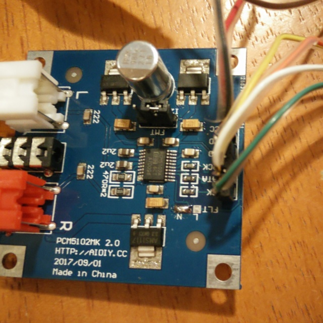

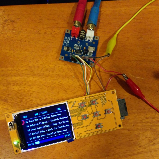

I powered up my board this morning - it appears to work anyway. The 2 cheap dacs I ordered arrived too so I have a bit of building to do now. First step is to build it stock and then work backwards.
No sign yet of the clocks or adaptor boards.
I've been pretty impressed with this - and just using a cheap but decent I2S PCM5102a board from aliexpress as DAC too. Hardly an optimised implementation with too long I2S connection etc. Holds significant promise.
